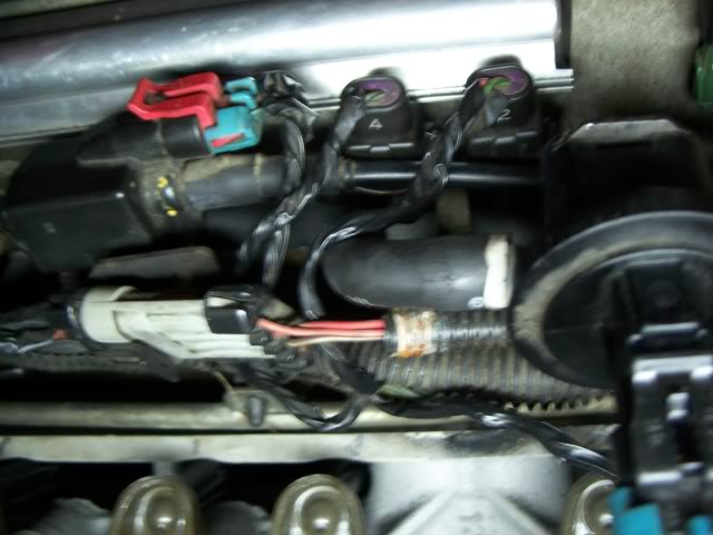

ok so I've been going over everything..again, and noticed another questionable thing on top of those^^ grounds. I noticed a pic of the EVAP system on shbox's site doesn't match mine>
he has the same type of tube coming out the bottom nipple as he does the top one while I have a rubber hose going into it from the EVAP solenoid, which I had asked about earlier on and got this answer>
QUOTE=SS RRR;12093851]That is the purge solenoid for your evap system. The tube on the left goes into a line which comes out of your drivers fender. The plastic tube goes under your TB and the solenoid goes to a mount on your passenger side bolted to the intake. There is then a plug that is located on part of the harness cluster on the passenger side. The rubber hose on the solenoid does not plug into anything.[/QUOTE
I just assumed SSR was mistaken saying that the rubber hose does not plug into anything, does it or don't it plug into the intake mani? cause here>
http://shbox.com/1/evap_sol.jpg
it says the bottom nipple plugs into the plastic line bundled w/ the fuel lines..but that goes to the evap solenoid.. I wouldn't suspect this is actually the root of my problems, but I'm running out of ideas.
It does not match yours because mine is a 1995.
http://shbox.com/1/1996_evap.jpg
