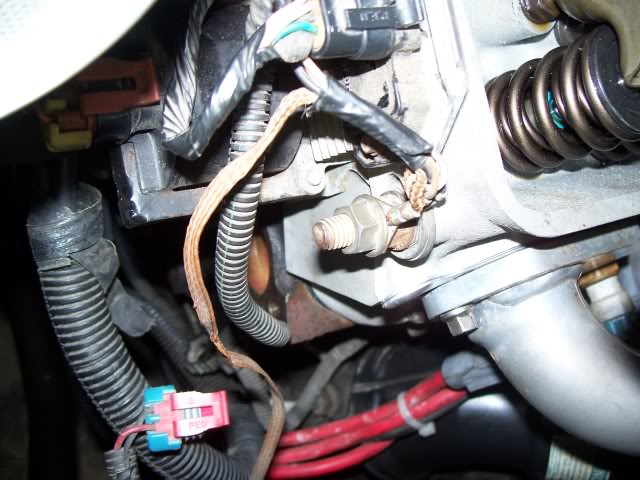

well it fired right up but was running rough again and started stumbling so I went to give it some gas on the TB and when my hand got close to the rubber intake boot I started getting shocked. is this a ground problem? the only ones I took off were the two on the coil and they both go back onto the right mount bolt for the coil right?

do I have these grounds right? I put the double one on 1st than the single one. I also pulled that pig tail back out because its was suspected to be for the AIR pump but never positively confirmed.
I triple checked the wire connections and order. ...don't know what else to do
