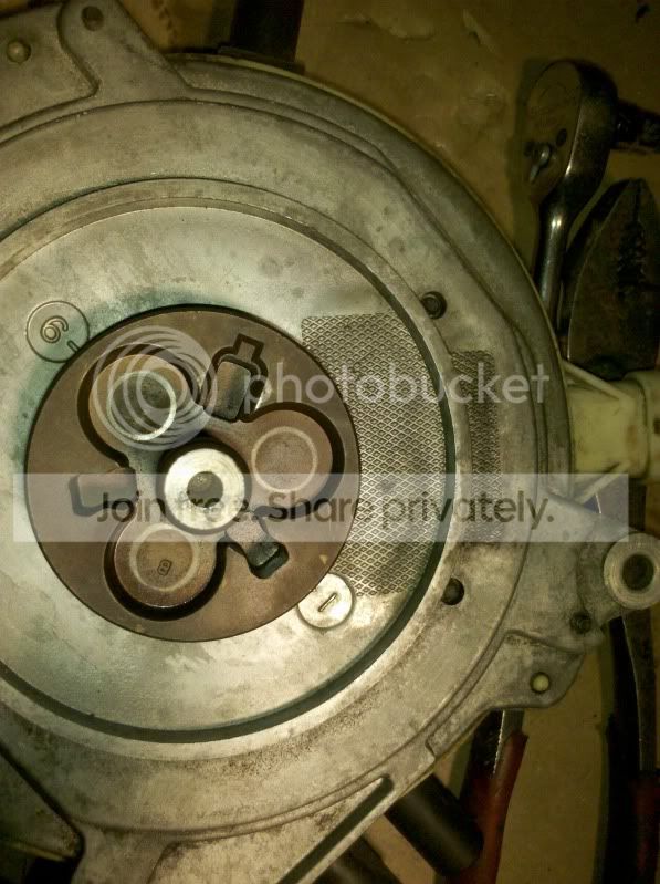

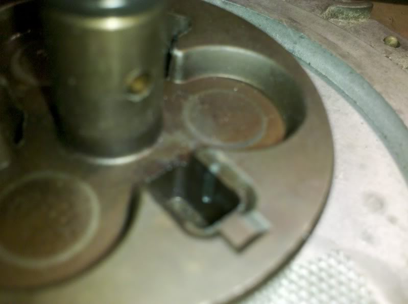

Headers still glowing, still not running right, no throttle response. He checked out a few things, all signs pointed to timing. Optispark questionable. Decided "let's replace the Opti and go from there." Pulled the Opti out, and found this:
Note the amount of exposed thread behind the cam gear. and how short the dowel pin looks due to the gear being out so far. No, there was not any Loctite on the bolts.
Pushed the gear back to the cam, and this is how it looks. Full length pin, bolts backed all the way out until they came to a stop....
...Resting against the Opti. I can't imagine the optical sensor liked this too much.
