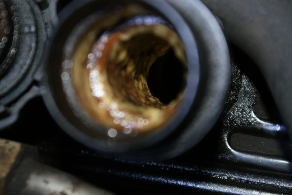

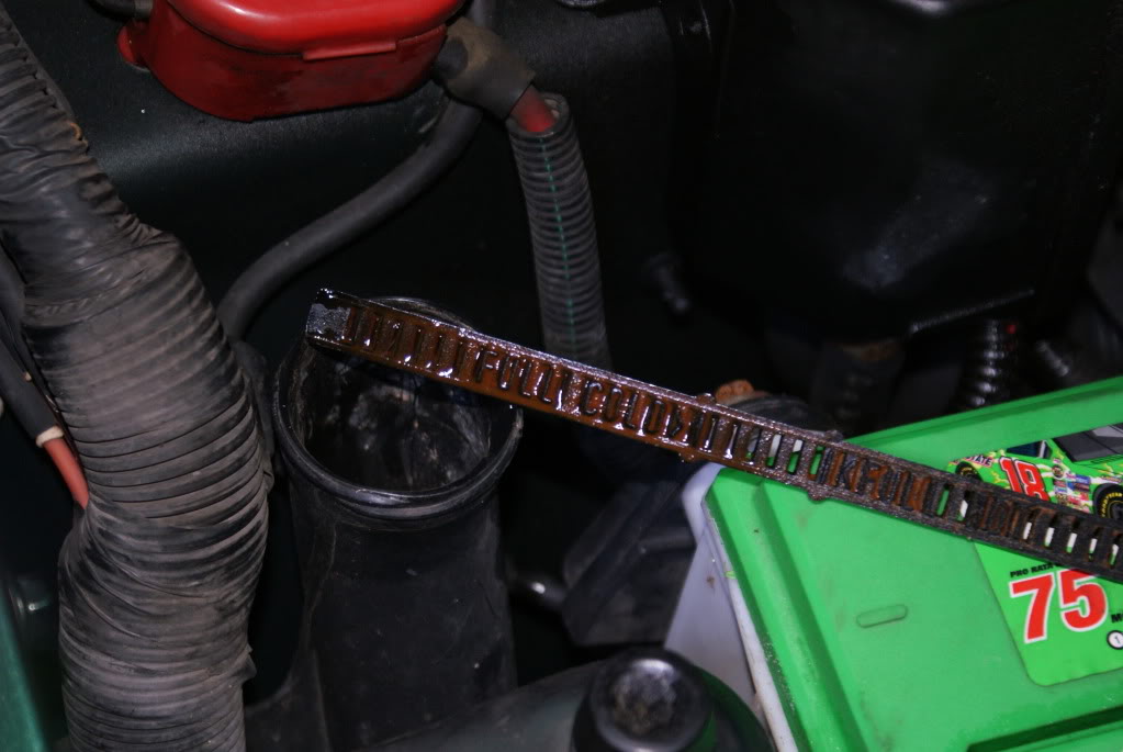

Fred mentioned something "more serious" could be wrong with my engine. Could it be possible that I have a blown head gasket? There is brown/ milky condensation on my oil filler cap. I was told short drives can also cause this, as I only drive 10 mile round trips to and from school. My car does NOT overheat (stays at about 180 degrees) and my coolant is not low.
I'll post some pictures.
What do you guys think?

Old Jan 29, 2012 | 07:11 PM
Gtpguy's Avatar
Joined: Sep 2003
Posts: 860
From: Seattle
Re: gas mileage
Sickening. I'd clean that filler neck immediately. Just gross to look at.
