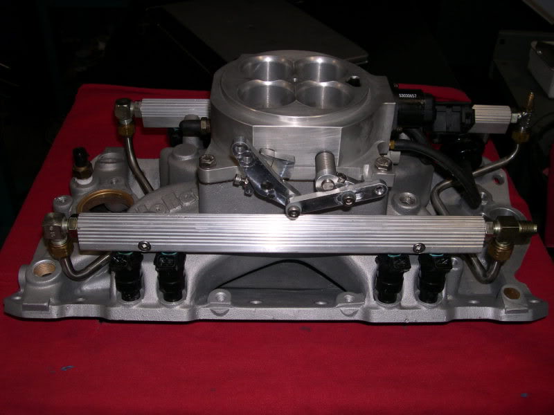

This is what it looks like.
The injectors don't have clips that clamp them in. Its held in by the two bolts through the fuel rail. At first I thought the injectors were too long, so I had the four mounting holes for the fuel rails (two on each side) welded up and re-tapped. We had to clamp the fuel rail down to get the bolts to start even after this. But now I can install the bolts while just pushing down on the fuel rail. I don't know what happened, but I don't think the injectors and being held down tight enough now.

I pulled the rail off, welded up the two holes that hold the fuel rail down and re tapped them so it holds the injectors in tighter. I had to get a 4x4 in there and pry down on the fuel rail to get the bolts started. I think the problem was that the o rings were kind of sitting on top of the fuel injector boss bevel instead of down into the bosses. Hopefully this solves the problem. I taped everything up so metal shavings didn't get into unwanted places and had a fire extinguisher handle, just in case.
