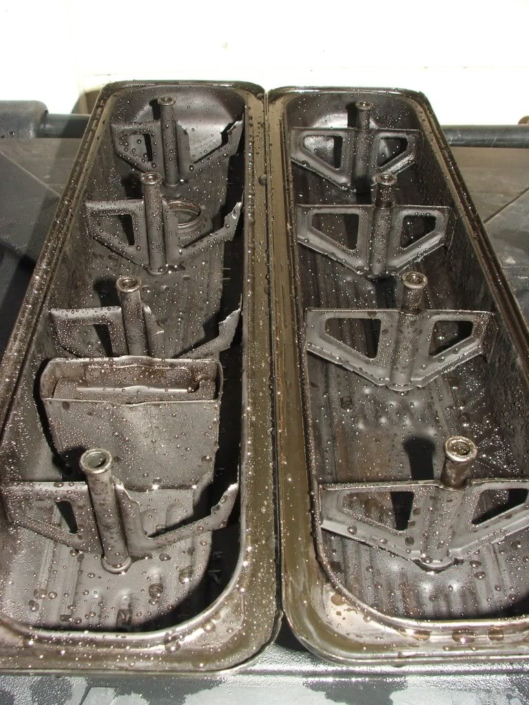

all roller rockers require clearanced valve covers. looks like this.
left one is clearanced and the right is stock
Instead of cutting out those baffles you can just bend them straight instead.
im not sure never tried that. i just cut them like this fits perfect no issues.
