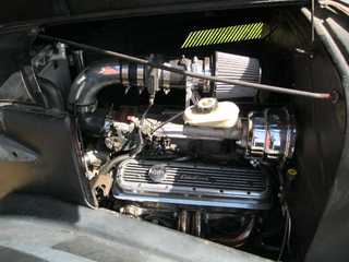

Downloaded a bin from Fbodytech.com for a street rod with a 95 Lt1 driveline.
Using an OTC Nemysis datastream the cars temp is approaching 190 F and the fan is not triggered. A10 and A11 OFF
Studying the bin the trigger temps they are 95 degrees C (203 F) low speed and 104.75 C (220 F) high speed.
Are these temps correct?

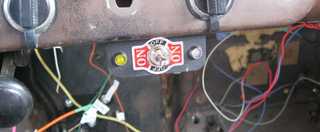

OK..built the manual over ride switch with LEDs (ShoeBox diagram). Work great, click left, left LED on and low speed fan, click to the right, fan speeds 1&2 and both LEDs are on.
Looking at the diagram it appears that the LEDs will activate as the PCM supplies signal grounds even with manual switch off (in center position) which is OK with me.
Will this combination affect any DTC's?

Yes, the LEDs will act like tell-tale lights when the switch is not in use (I actually have them on my car, but with no switch). If wired like the diagram, PCM operation of the fans is not affected.

I has one code for fan relay control circuits and II has two codes (one for relay 1 and one for relays 2 and 3).
