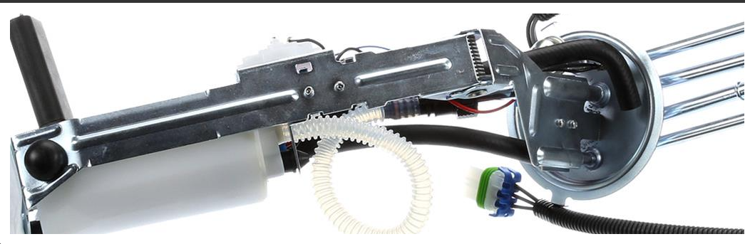

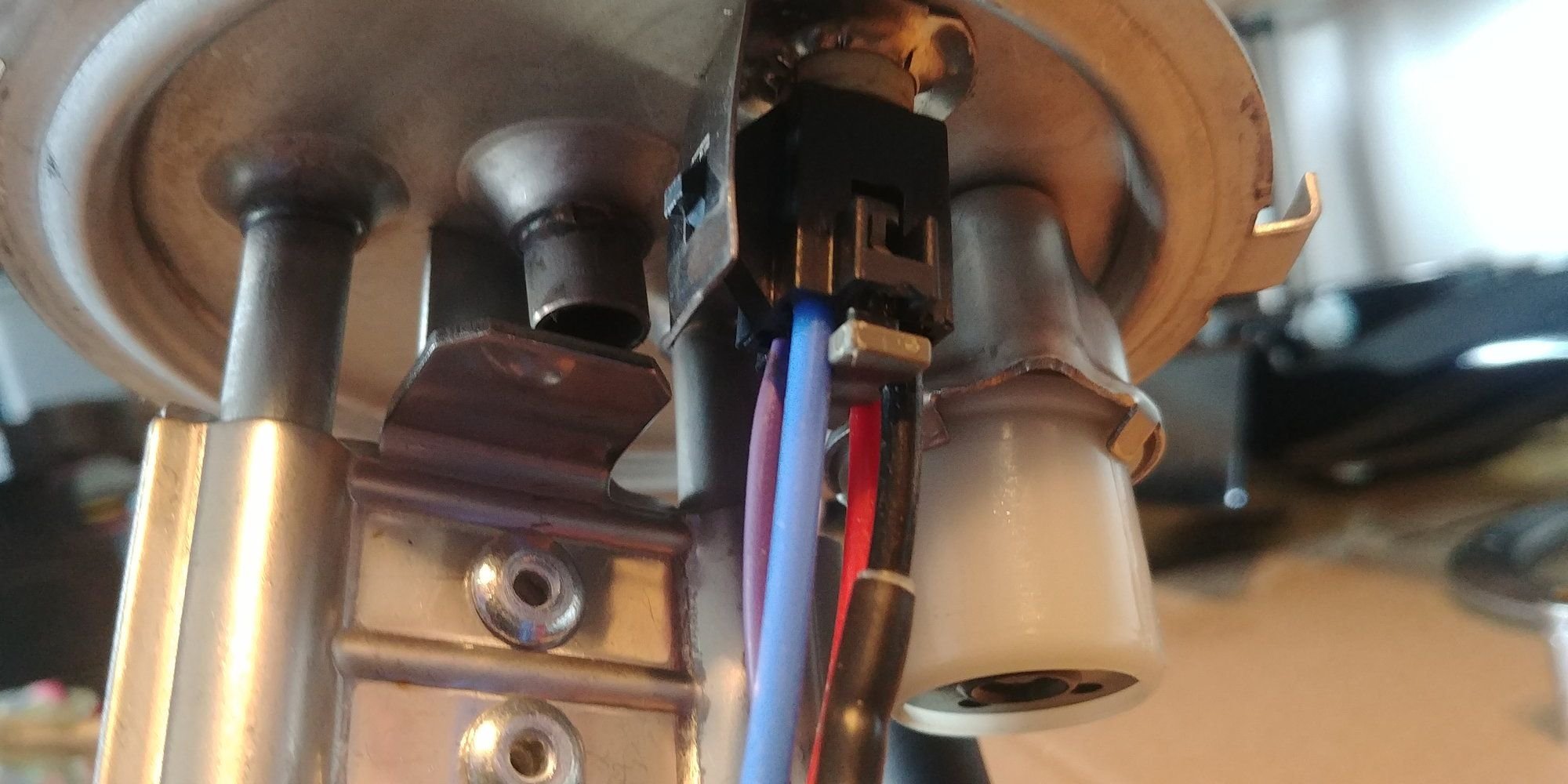

Grabbed a couple of pump pics from one of Adsoyo's fuel pump issue threads.
When looking at the pic below trying to identify the lines, going from left to right numbering them 1-4. Just to make sure I'm not goofing the line type....are these the line functions?
1. Fuel return
2. To EVAP canister
3. Fuel feed to injector rail
4. Fuel tank vent valve
For what I think is the fuel tank vent valve line...any idea what crimped to the port? Edit:Looks like fuel tank vent line actually connects into the bucket and is routed behind whatever the crimped thing is.....so is this line submerged into fuel at all times?
Top view....
Side view...

Zooming in on this....I may have the EVAP line and fuel tank vent valve line reversed. Even so...I'm not sure why the EVAP line would be connected to the bucket, which is submerged in fuel most of the time.

The vent line is the one with the rectangular tab right below it.
I think the white plastic cylinder is the rollover valve. If you need better pictures of sending unit, I have a spare unit I can take pics of. Unfortunately it does not have the hose connecting the return to the bucket.

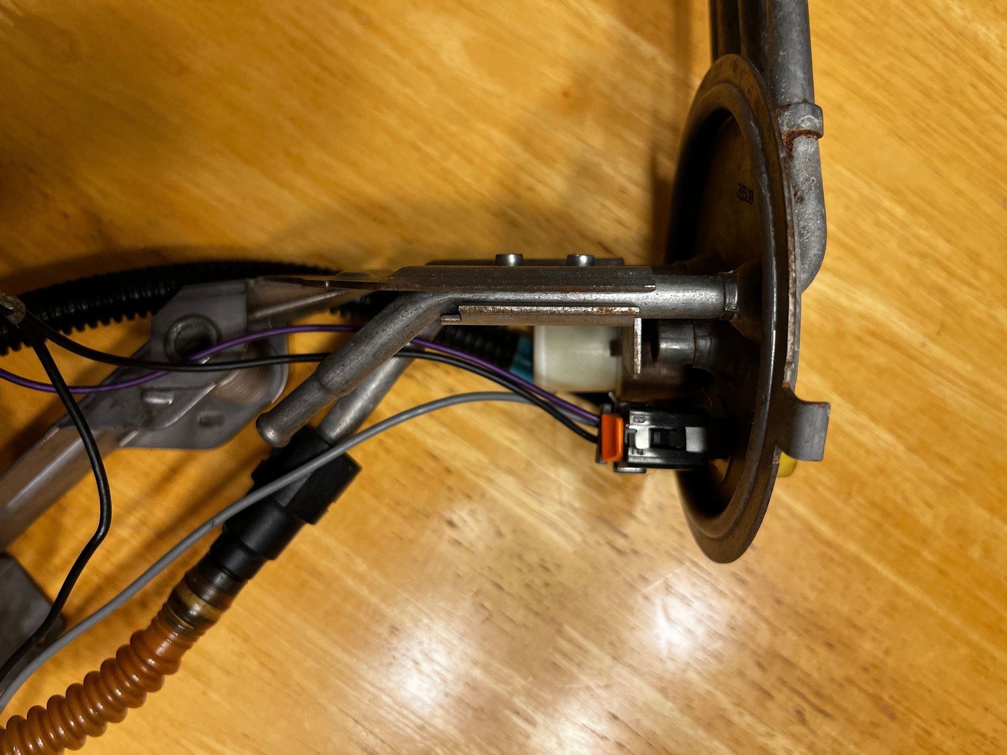

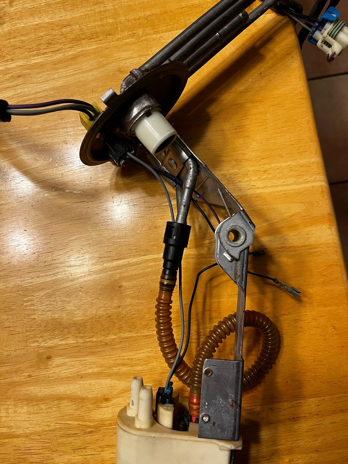

I'll try to take a pic tomorrow. I do have a morning appointment for a cortisone shot in a failing hip. Not sure how agile I'll be for the rest of the day.

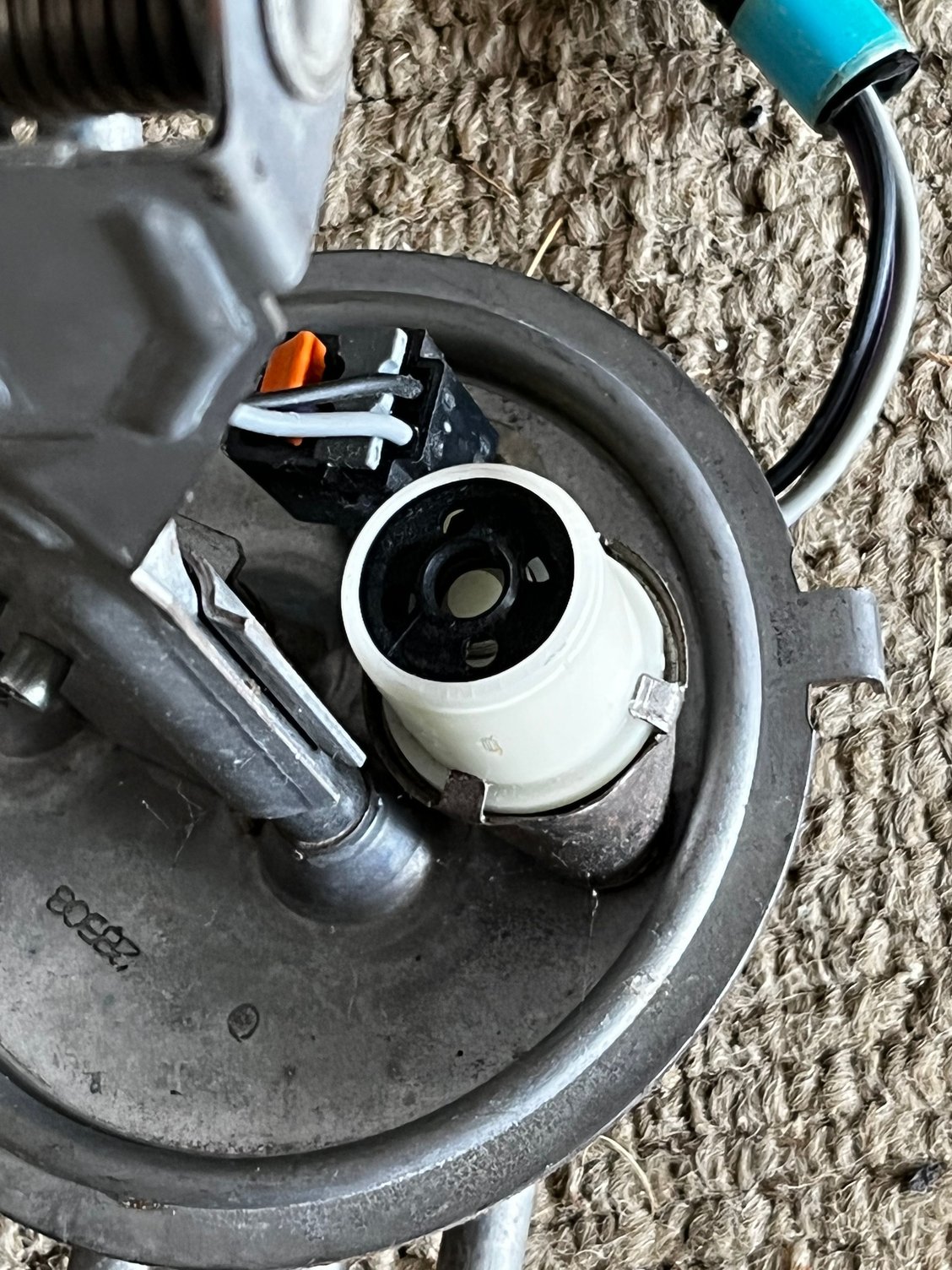

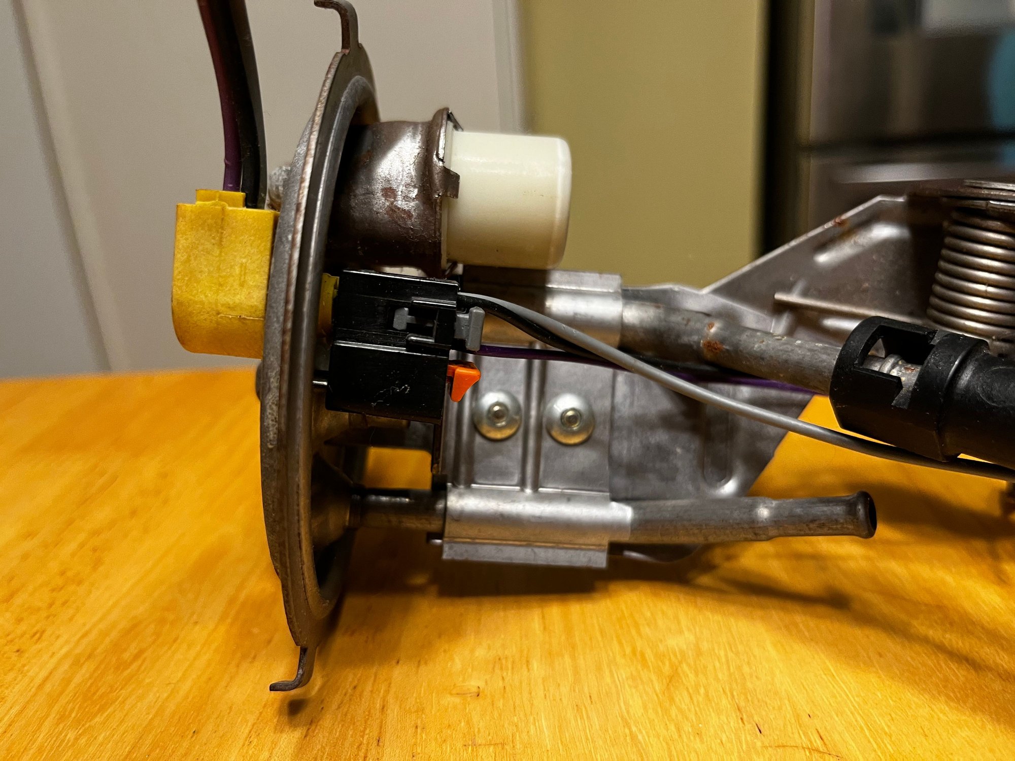

The pump bucket has two nipples on it. One for the return is obvious. Not sure about the second, if that’s where the EVAP is supposed to go. My sending unit was a “spare”. When we built the fuel system for the stroker build, the shop pulled the original sending unit and replaced the stock pump/bucket with a new Bosch pump. They threw the pump/bucket in the surplus parts they returned to me when the project was done. May have included the rubber hoses, not sure, but if they did I don’t have them any more.
When the sending unit float level sensor failed, we had to buy a whole new sending unit, less pump and bucket. Removed the broken sensor and pop riveted the one from the new sending unit. In 2001 you couldn’t buy a separate level sensor. I can’t even remember why I put the old pump/bucket in the new sending frame.
Old Jul 26, 2022 | 01:41 PM
Posts: 71,119
Re: Excessive fuel tank vapor pressure...

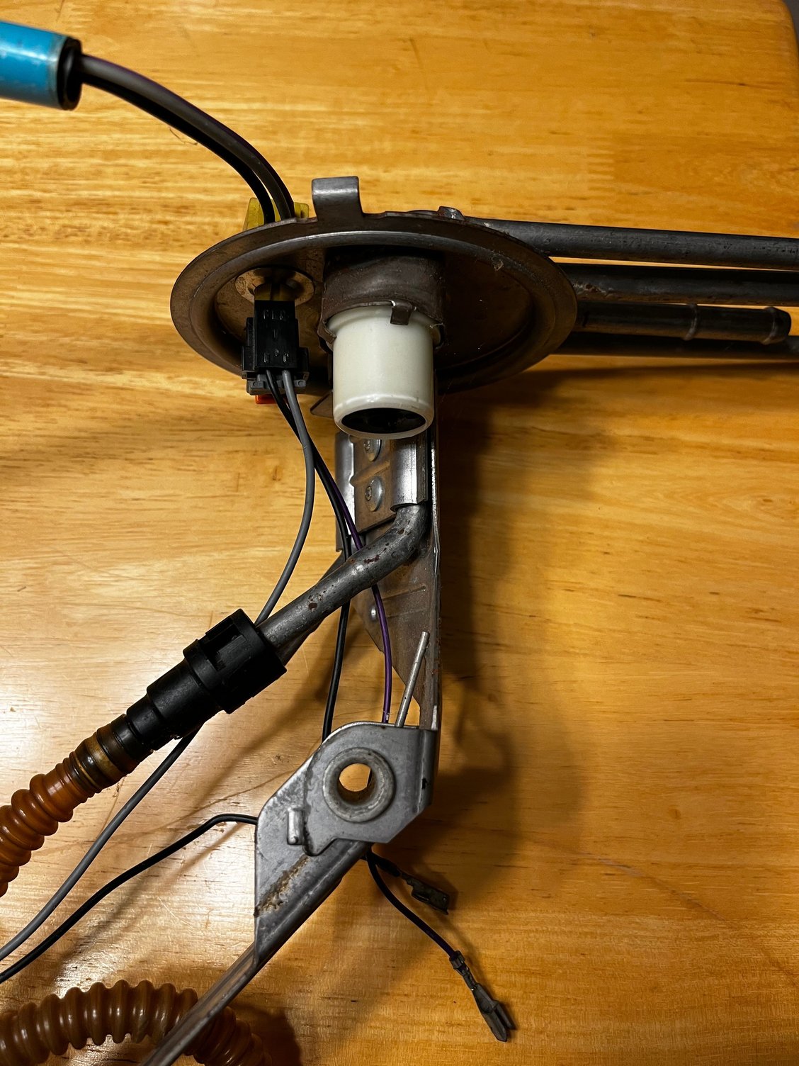

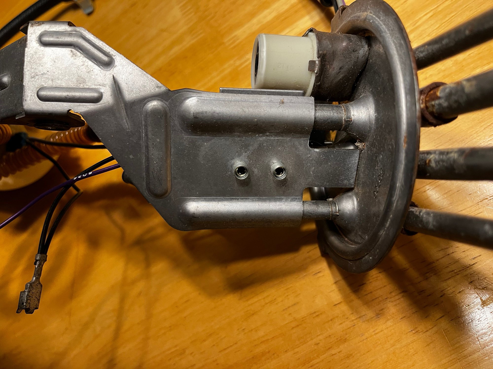

Just speculating on the EVAP line being routed from the bucket. The fuel in the bucket cools the pump, picking up heat. While it is constantly replaced by the return stream, that stream could be warmed by exhaust or simply by the energy of pumping it. The fuel in the bucket is most likely to be the warmest, and generate more vapor. Send it directly to the EVAP system. Just a guess.
What is unclear to me is how that hose attaches to the rollover valve. Hard to tell, since I don’t have the hoses on my “spare”.
Photos:
Old Jul 26, 2022 | 01:44 PM
Posts: 71,119
One more:

Appears there is a discrepancy between my photos and the elevation view diagram of the sending assembly in the 96 factory service manual. There is nothing shown attached to the rollover valve. There is a line identified as "4 - Vent Hose" from the pump bucket, that disappears behind the rollover valve. It is retained in position by "3 - Vent Hose Retainer". The retainer appears to be at a level 3/4" below the bottom of the rollover valve, and the hose slips into an opening. There is nothing like that on my sending unit (which the shop purchased, so I assume they ordered one for a 1994).

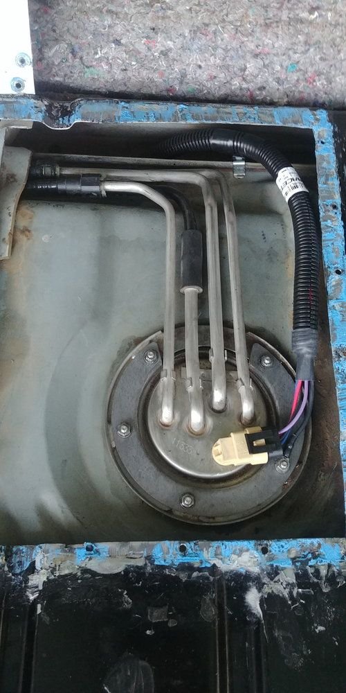

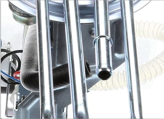

Finally found a couple pictures that may bring the EVAP picture into focus. Looks like the EVAP bucket hose is open towards the top of the tank. I think that makes the roll-over valve open in the top of the tank until the car gets upside down. On bottom of page 6C-3 the FSM mentions that the roll over valve is pressed into the EVAP tube. I was confused as I thought the bucket hose somehow connected to the EVAP hard line exiting the top of the pump.
