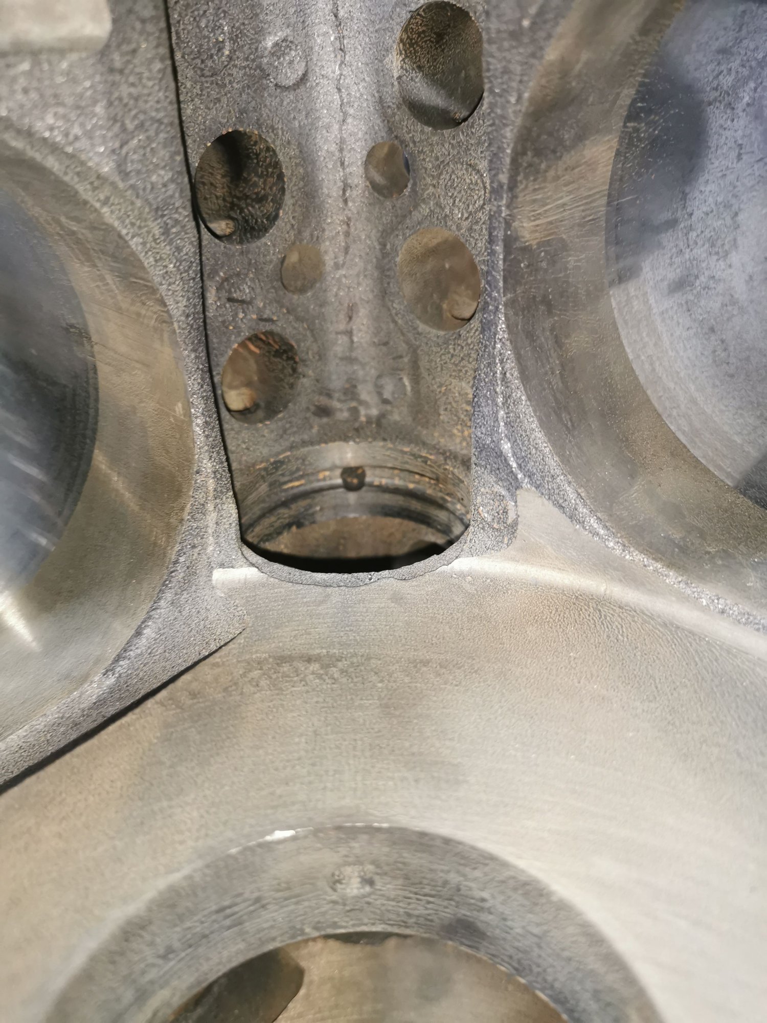

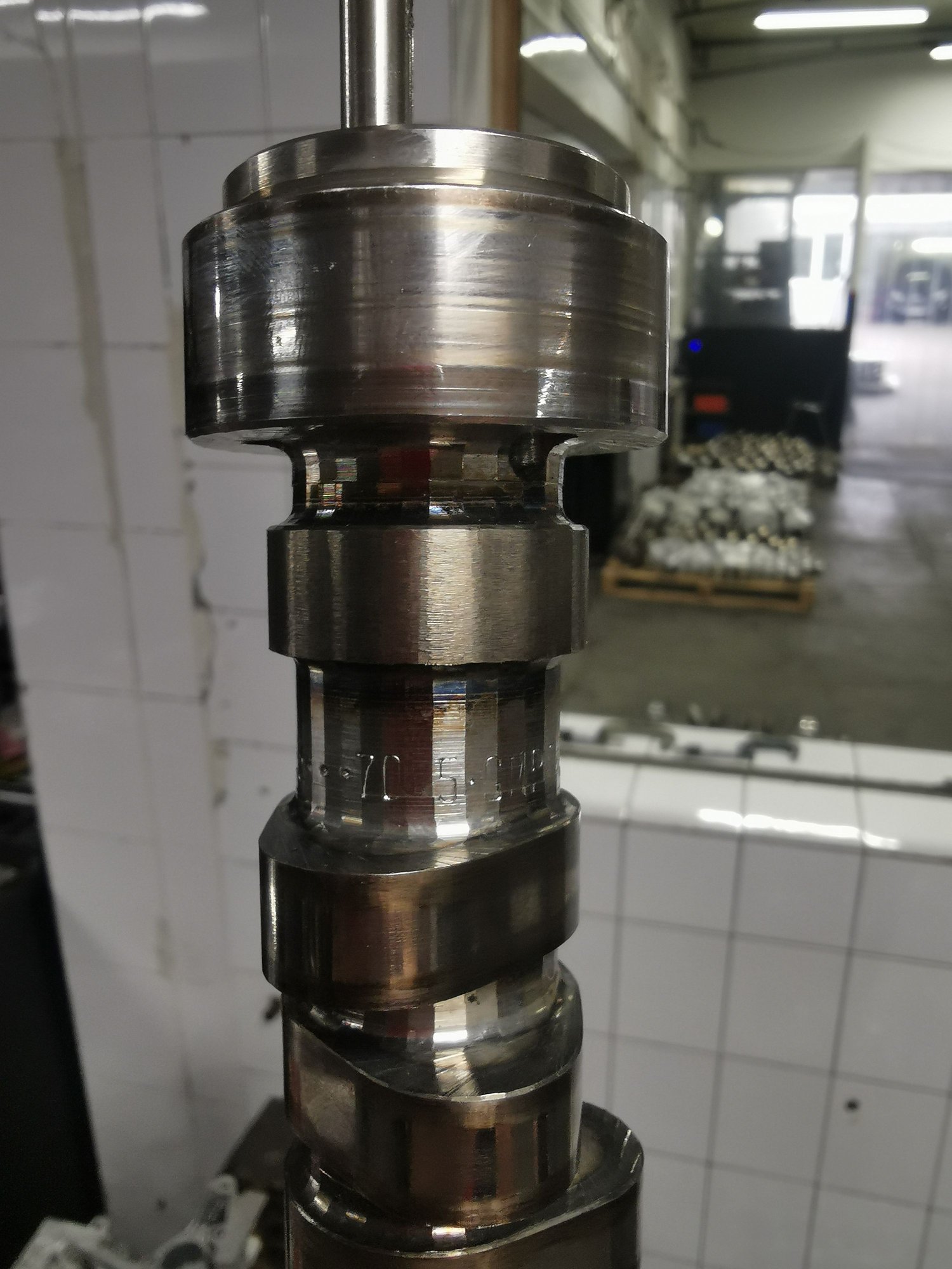

The whole engine has been pulled from the car and now I see the problems with the camshaft bearing, first on the camshaft housing was literally fell out, the second one deformed and latter are on their positions when we removed the camshaft.
The main problem so far is the damaged cam housing at the entrance from camshaft moving because of the bearings and now I contacted you to find out the info which diameter is of cam housing where the bearings come in, in order to find out what is the best possible scenario to fix an issue and remain in the GM engine ervice manual specifications.
​​Also, the camshaft doesn't looks so god, so I'm in a chase to buy another one with stock specs, don't plan anything to tune, because all of the stock parts are on the engine, 56k miles so far, want to replace with another stock parts if it is possible.

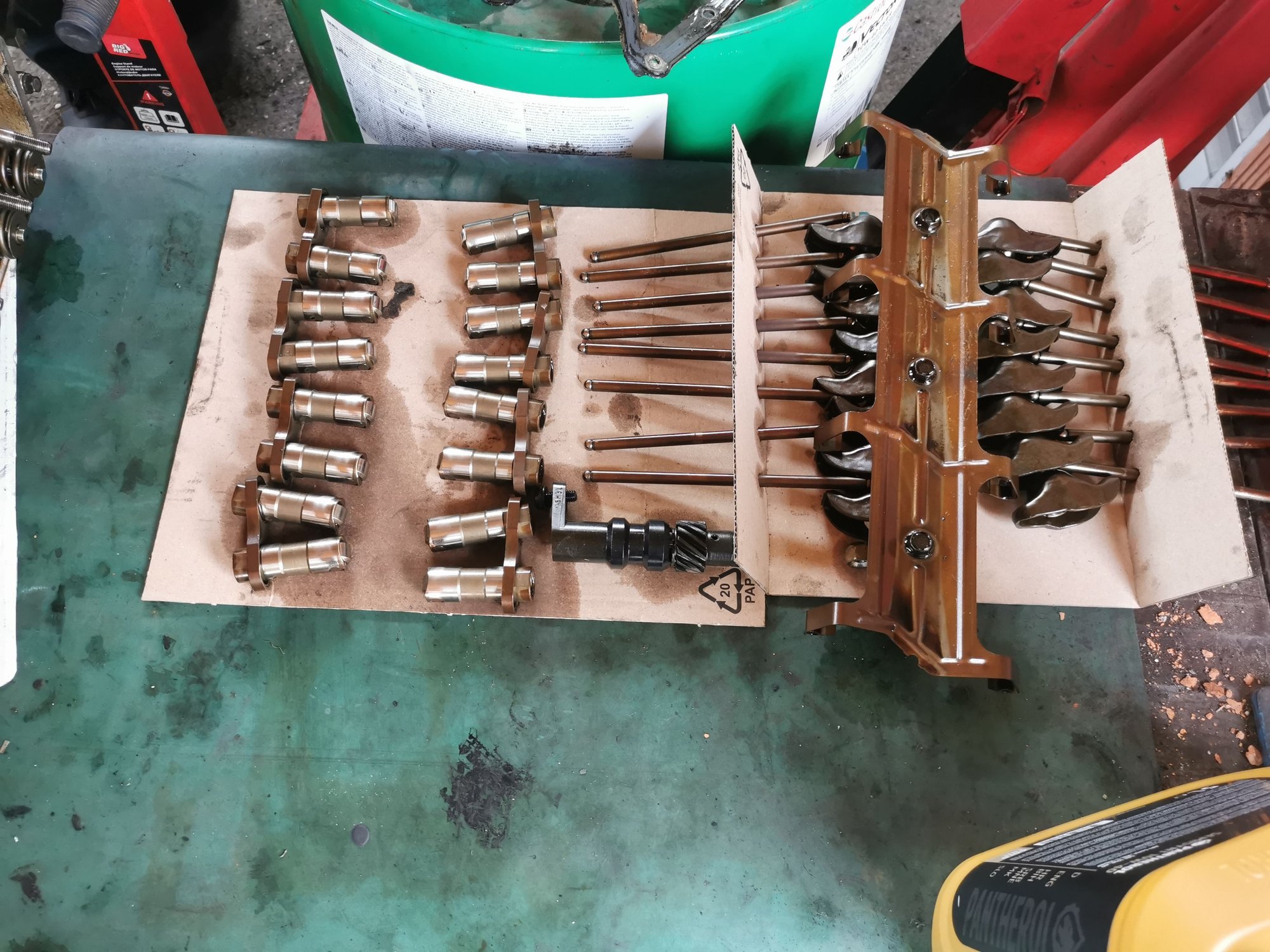

So far, inspected pushrods, valve rocker arms, valve lifters, pistons, connecting rods, oil pump, everything looks fine and on its place.
If there is necessary and important to buy a more new parts to replace especially for this case, I will do it without any hesitation, what has to be done will be done, no doubt, I have an enough time and a solid amount of budget for this, so not a problem.

I will try to find out the same one stock GM cam, because I don't want to change lifters, since they are stock ones and very fine, in good shape without any bad sound and noise even with this zero pressure problem and also visually without any damages. Will inspect for rockers, great suggestion. What did you mean for pushrods, replacement, didn't understand you for that very well?

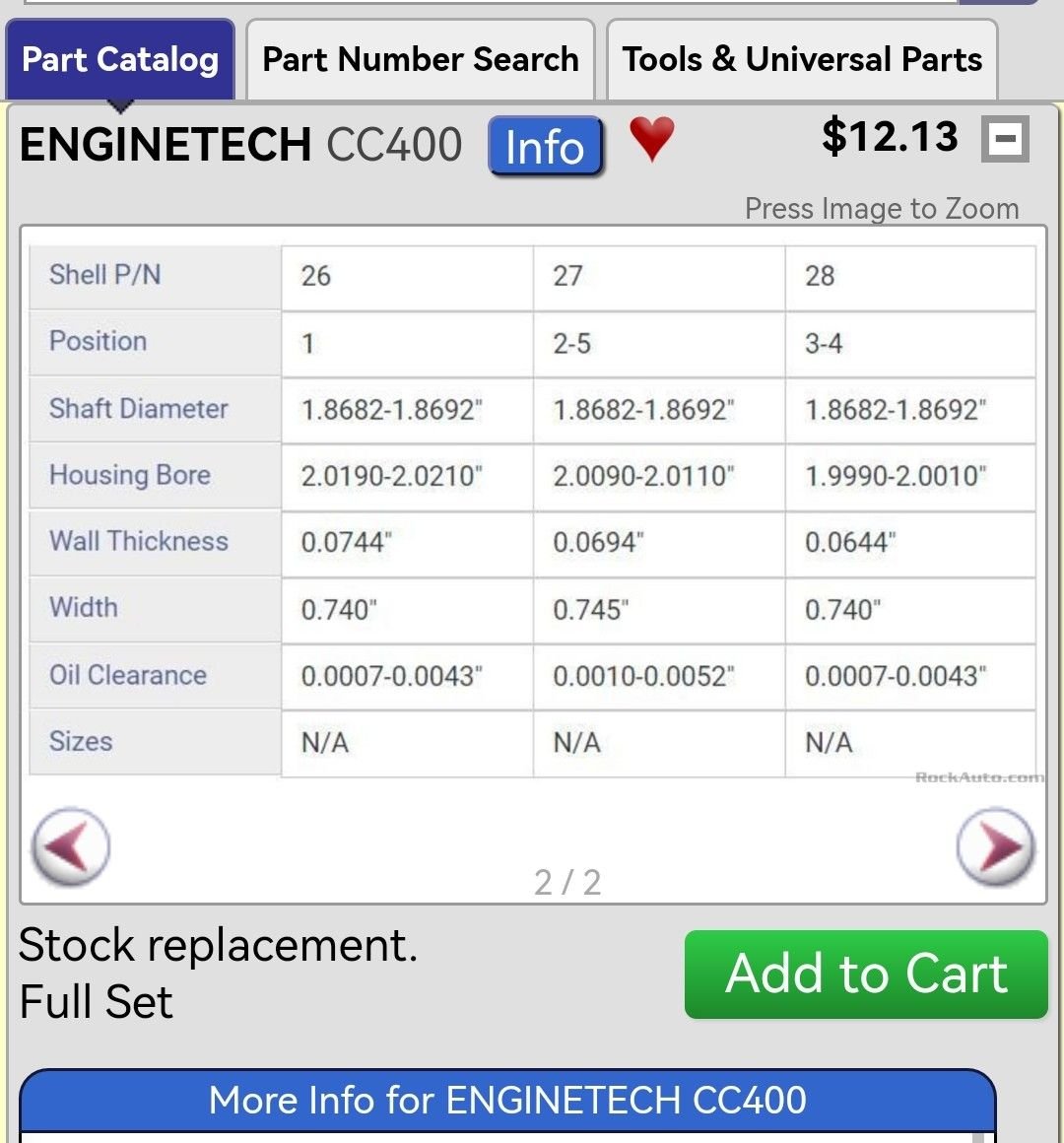

The problem is with the damage on the entrance where camshaft comes in the block, the first two bearing almost fell out and the camshaft was loose because of that and have a some undesirable movement in the block while car was driven and damaged the housings/sockets where the bearings come in, the first two are in the problem, the third, fourth and fifth are fine, I don't know better to explain with my English, don't know how you call it precisely. I'll attach the pictures just to better understand what is the main problem to solve now and what is the best possible to do in this situation?

I would get an opinion from a competent machine shop on the cam bearing journal surfaces. They can measure the bores and inspect the damage to see if there is a real problem that can't be remedied.

Okay Rob, thank you. I was searching for cam bore diameter measurements, but haven't find anything so far, only found for the LT1 V gen engines.
I found the cam housing bore diameter measurements when searching on RockAuto and Enginetech site for cam bearing specs for a listed options for our engine. I find something, maybe that can be useful information for machine shop.
If you or anyone knows any of these info, please let me know, because machine shop asked me for that info since they didn't know that measurements also, but I didn't know to tell them. Hope to resolve this unpleasant issue soon and continue to progress with the repair process further.

If nothing else, a shop should be able to measure any of the bores that have no damage and use that to compare.

Thanks for help Rob, I contacted them a couple of hours ago and provided them the cam bearings measurements so they can compare with the cam bores in the block and figure it out what is the best solution.

Do you have a copy of the 1996 factory service manual? If not, it can be downloaded here, courtesy of member GaryDoug:
https://www.mediafire.com/?40mfgeoe4ctti
On page 6A3B-53 it does have some camshaft data, including journal diameter, end play, lobe lift. But that's all. However there are detailed assembly procedures.

Thank you very much Fred on your help as always. I have a service manual, printed from PDF, easier to look at the paper form and work.
I found a measurements for a whole bunch of things and I think it will be more than enough, now should concentrate on your advice for LT1 book on kindle and search if there's more valuable and detailed information about whole procedures in rebuild.
