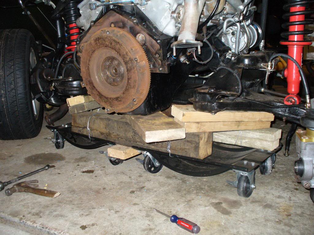

I dropped my engine 3 times, all through the bottom. using a cherry picker and a 1/2ton jack. doing it on the grass, I would throw down some pilewood sheets so you can roll a cart made out of a car dolleys and 2x4's and wheel the k-frame and motor around, out and in. believe me. having center of gravity in the middle of the K frame makes it A LOT easier to realign the K frame bolts. You need to use a cart, tried w/o one and the wheels and struts collapsed inwards making it near impossible to to realign. Pulling out you dont need a cart.

The tops of the shocks may try to lean inward, but all you need to do is wedge some wood between them and the motor or put on your shock brace if you have one. I used no cradle and had no problems.
