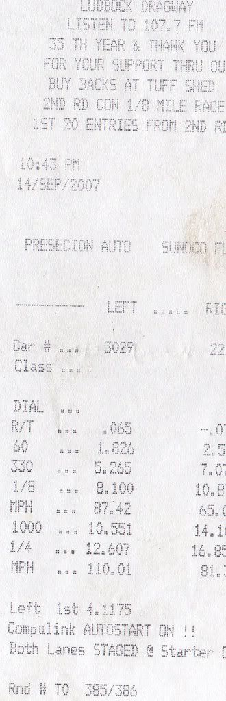

just went to the track and ran a 12.607@110.01 w/ a 1.826 60'... with a DA of 5400'. New best so I am happy... will get dyno graphs and timeslip up today.
