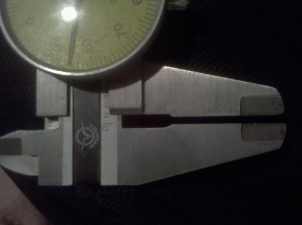

caliper at 0 (ignore the dial its off alittle i went by the stamped area)

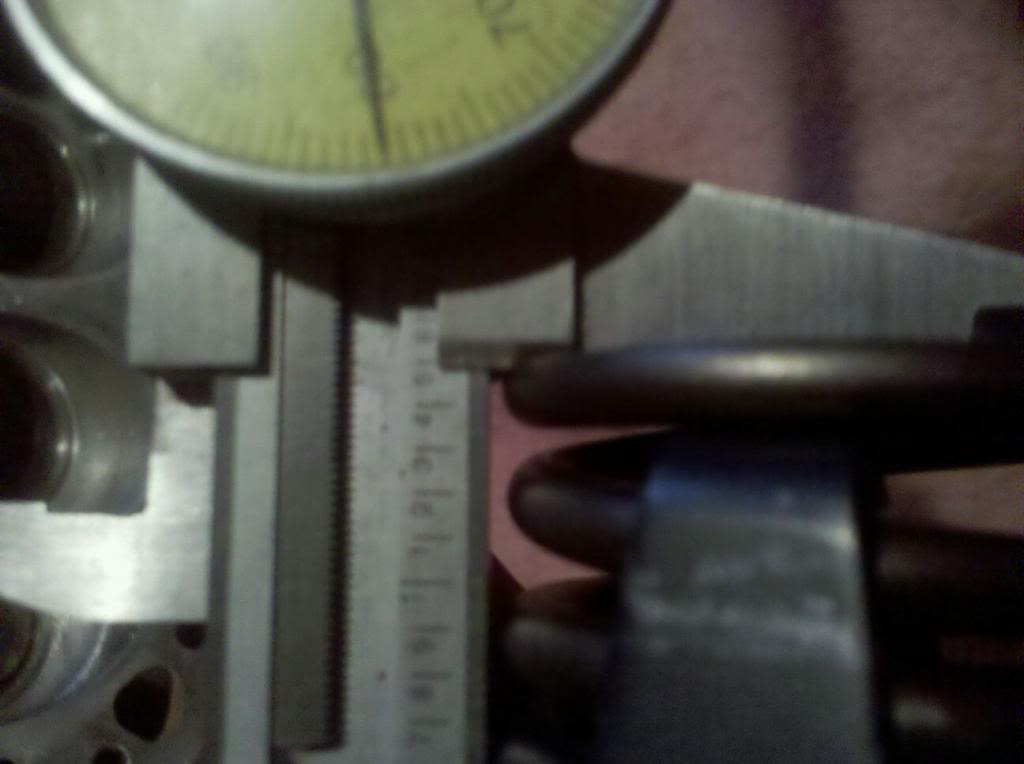

spring compressed to 2in

spring compressed .520 thou past 2 in

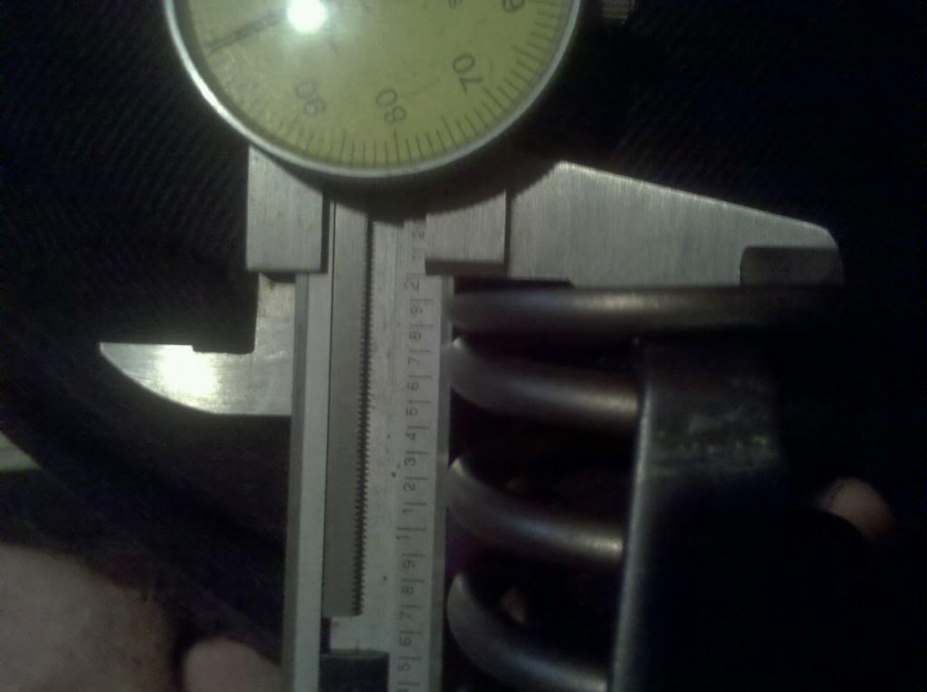

spring gap inbetween coild compressed .520 thou under 2in (pic 1 coil 1)

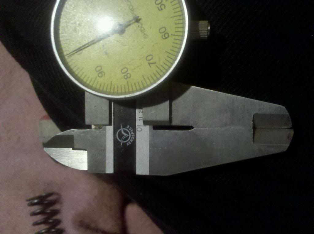

spring gap inbetween coild compressed .520 thou under 2in (pic 2 coil 2)

so it looks like i have from 60-90 thou of room between coils does this mean i can use the springs and not worry?

if you now have a spring locator that fits the head properly (no slop around valve stem guide base) and clears the inner spring just install two on any cyl (#1) then rotate engine and when spring is fully compresed look to see if there is any clearance between coils which should be a min of .035. also confirm you have no rocker to retainer conflict

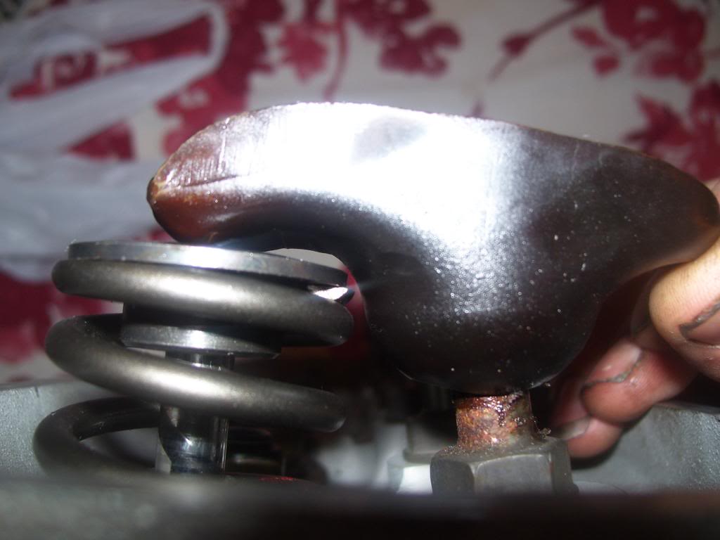

just checked rocker to retainer clearences, not a single problem. no rubbing or touching at all, pics below, im using stock rockers for now as to not over do it with the springs, so i now prob have an almost stock lift cam in it, so ill end up swapping springs next time i get the extra cash and time ill install my 1.6s on there and new springs, just dont have the cash at the moment.
