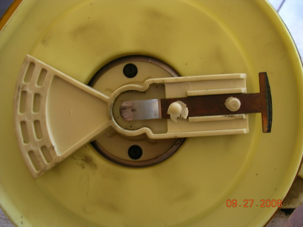

does this look like its bad??
Old Sep 27, 2008 | 02:03 PM
jer4251's Avatar
Joined: Mar 2002
Posts: 1,191
From: Richmond Hill, GA
does this rotor look like it would be hurting performance?
Old Sep 27, 2008 | 02:59 PM
mrmint69's Avatar
Joined: Oct 2006
Posts: 2,731
From: Post Falls, Idaho
Mine looked the same. I replaced it and it ran almost like before.
Old Sep 27, 2008 | 03:58 PM
LaredoZ28's Avatar
Joined: Aug 2006
Posts: 343
From: Encinal, Tx
the pic looks a lil dark. but the tip looks like its a lil burned though.
Old Sep 28, 2008 | 12:21 AM
Mtxz453's Avatar
Joined: Jun 2007
Posts: 377
From: Clifton, NJ
cap and rotor is a normal thing to replace under maintenance, when is the last time it was changed?
Old Sep 28, 2008 | 04:29 AM
dStruct's Avatar
Joined: Apr 2006
Posts: 82
From: Orange County, CA
The tip of that rotor is worn man, it needs to be replaced and probably along with an equally worn distributor cap. Most cases you can get a cap+rotor from Autozone for about $15 out the door.
You are aware this is for an lt1 right? Its going to cost 10X that much. And if you go to the dealer they quoted me $390 for cap and rotor, $490 for entire unit.
Yep, if you can get a cap and rotor for that cheap, either you're buying the wrong part or somebody is cutting you a MAJOR deal.
Old Sep 28, 2008 | 10:41 AM
jer4251's Avatar
Joined: Mar 2002
Posts: 1,191
a cap and rotor from autozone is like 140 bucks. i checked into that already. i was going to buy a brand new opti.
it would be nice if all i needed was a cap and rotor

From: Clifton, NJ
just got a gm opti from thepartsladi on ebay for 250, everyone on here gives her good reviews and it seems the gm unit is the most reliable
i looked into her already, they were 240 shipped the last time i looked. and 250 depending on what listing of hers you found. then i though about going with a dynaspark. i dont know what im going to do yet.
Ok so yeah I was WAY off, Autozone (my work lol) has the cap and rotor kit only and it's a regular stocked item at $229.99.. It looks complete with lots of little parts but man that's expensive.

Posts: 1,444
MSD Cap/rotor kits are $140 and have a better reputation that the generic autozone kits.
i went with a new delphi opti
