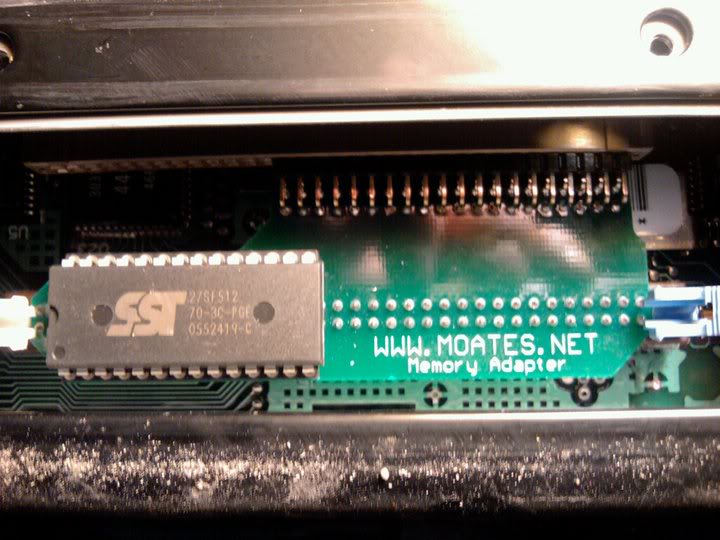

There we go all updated! Ok so I just took the pcm out and popped open the bottom piece and inside I could see the chip and it reads www.moates.net. I'm pretty sure they tune these cars. I assumed it was tuned as it runs just fine. Also the fans kick on around 180 so I knew it was programmed. Question is now what. Thanks a lot for the help guys.
Old Jan 19, 2011 | 01:24 AM
preston145's Avatar
Joined: Jan 2011
Posts: 19
From: charlotte NC
Re: Dissapointing Dyno numbers!
took a picture for you guys. this was in the ECU
