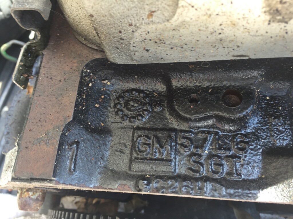

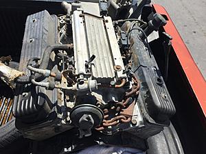

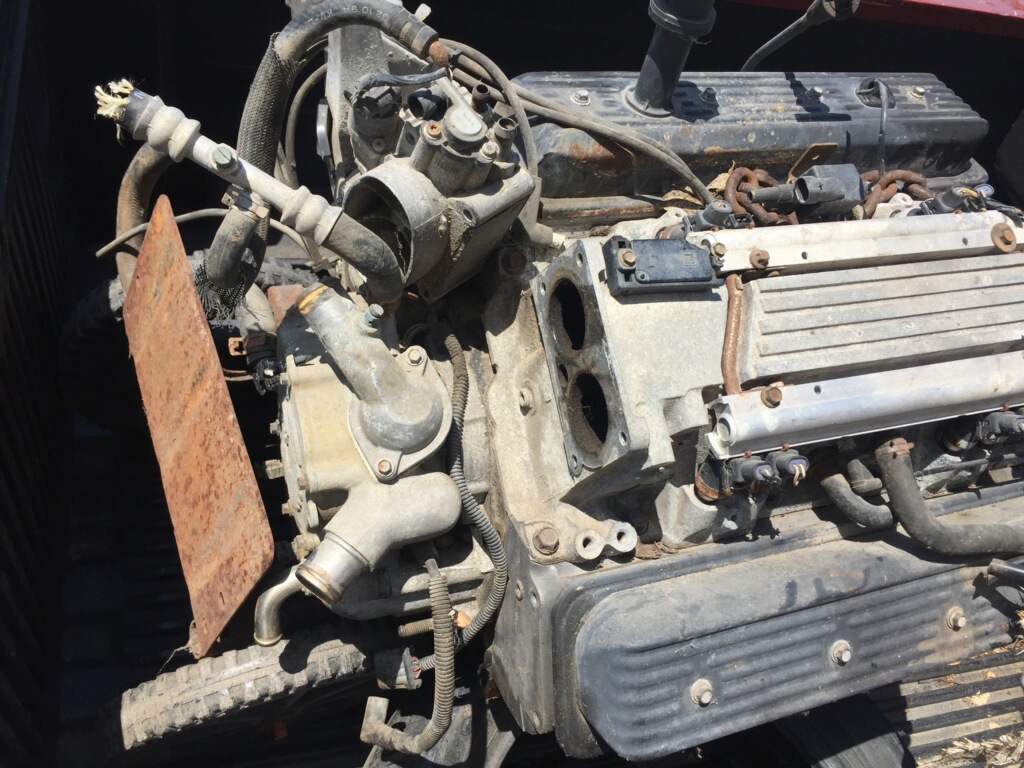

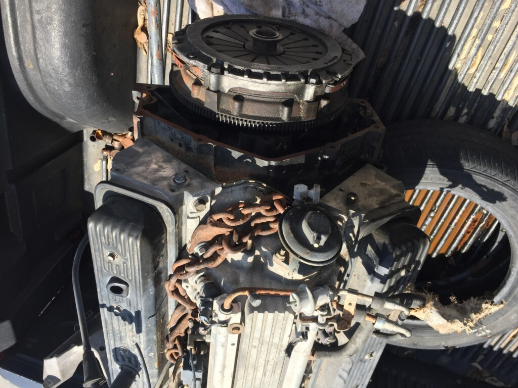

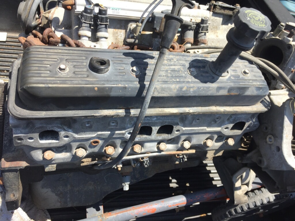

The Guy sent me Pictures of the corvette Engine I thought that on the corvette had the fuel lines on the pass Side Also looks to me it's been sitting out side I ask him if i can remove the oil pan
here are the Pictures

Beside the fuel lines, it has an F-body water pump and someone removed the steam pipe tubing from the rear of the heads. No composite valve covers, either. Don't think that is a "Corvette" engine, if that is what the guy is advertising. Everyone always thinks if they say "Corvette", it's worth more.

Is that a dual mass flywheel? that extension on the oil filler cap I don't think came on any vettes. If it is a vette engine, its possibly been bastardized by now. IDK if the VIN derivative can be matched up to a specific car. either way, its going straight to the machine shop, so other than not paying a premium price, I say go for it.

That looks just like the flywheel in my f-body...unless the dual mass ones looked the same I don’t think it is one....

accessory drive on a corvette is on the left side. The pictures show it on the right side.
