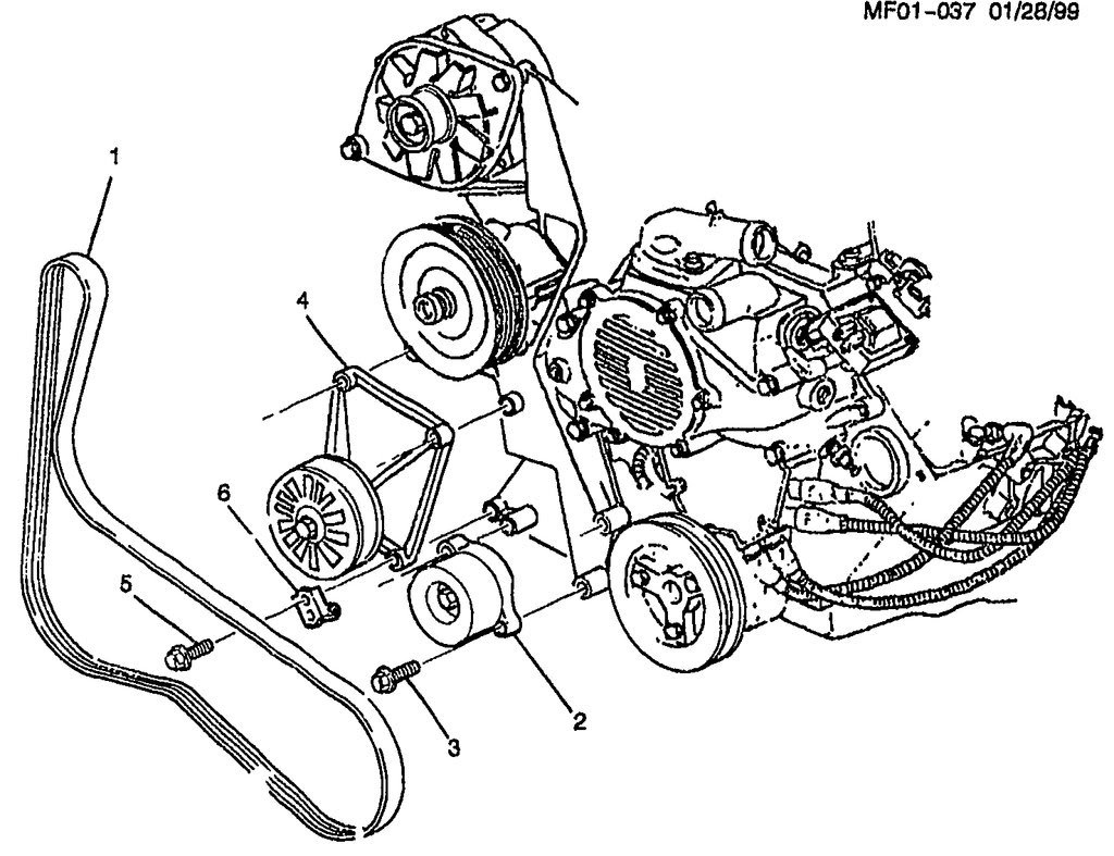

I believe I'm in dire need of new pulleys in my 96 LT1. Whenever I start the car, the engine screaches/squeals so loudly that you can't hear anything else. I've gone through 2 belts previously and this one hasn't been on for very long. It looks like the small pulley near they crank pulley is wobbling a bit.
Here's my problem. I'm a big noob when it comes to engine work. I don't even know which pulleys are called what. I believe I need to replace the idler and tensioner pulleys but, I'm not positive what they are called because I haven't seen a diagram with them labeled to know for sure. Of course, I would also replace the belt as well. Anyone got a diagram showing the front of the LT1 with the names and locations of all the pulleys? I need to know what to ask for when I go to place the order for the replacements I need. I have a buddy that is a top notch mechanic that will actually supervise and assist on the work I need to do but, I wanted to be able to order the parts and get them in sooner rather than later.

Here's the tensioner pulley... I would suggest to replace the whole tensioner assy and idler pulley...... Courtesy of Shoebox...

here's a drawing I have from a GM parts catalog, you want #2, the tensioner pulley
also, this site http://shbox.com/page/index.html is the mac daddy of sites for questions regarding the LT1
