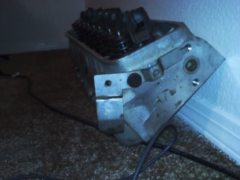

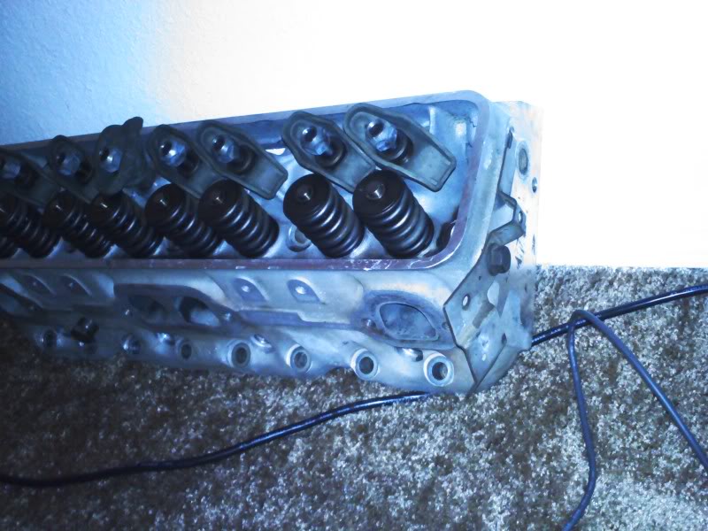

So i kinda forgot how this damn bracket went, (its the metal one that sticks out) any help???
Also being that there is 2 banjo bolts, is there supposed to be 2 seals on each bolt?

K i figured out the banjo bolt seals, should i put ARP thread sealant on the banjo bolts also???

Head, seal, steam tube, seal, bolt. No thread sealant necessary. The seals do the job.
The bracket is correct.
