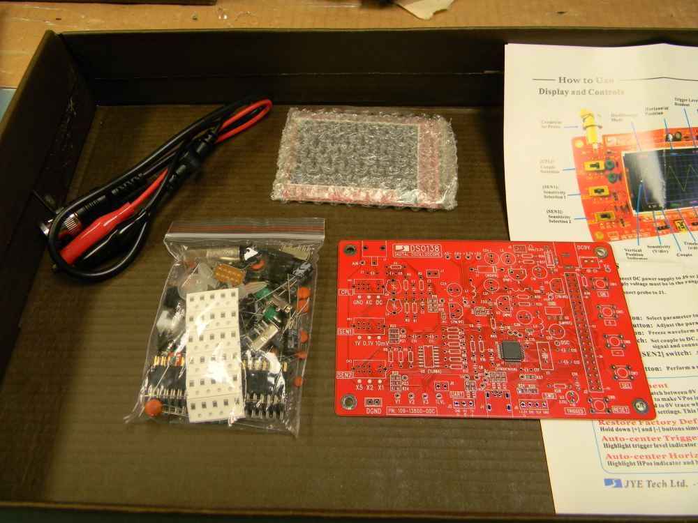

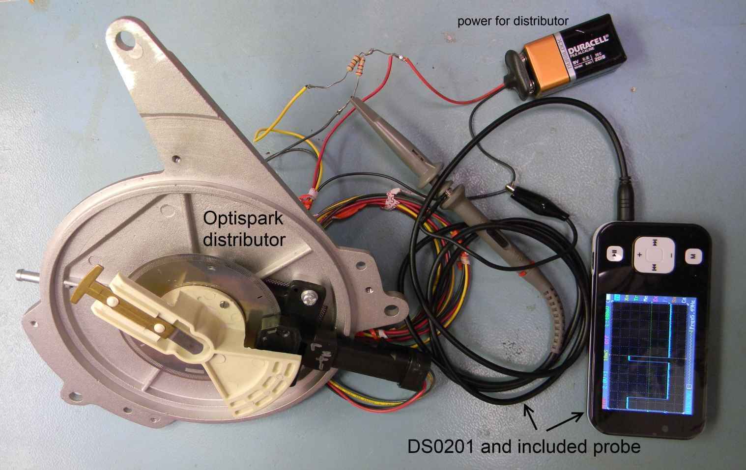

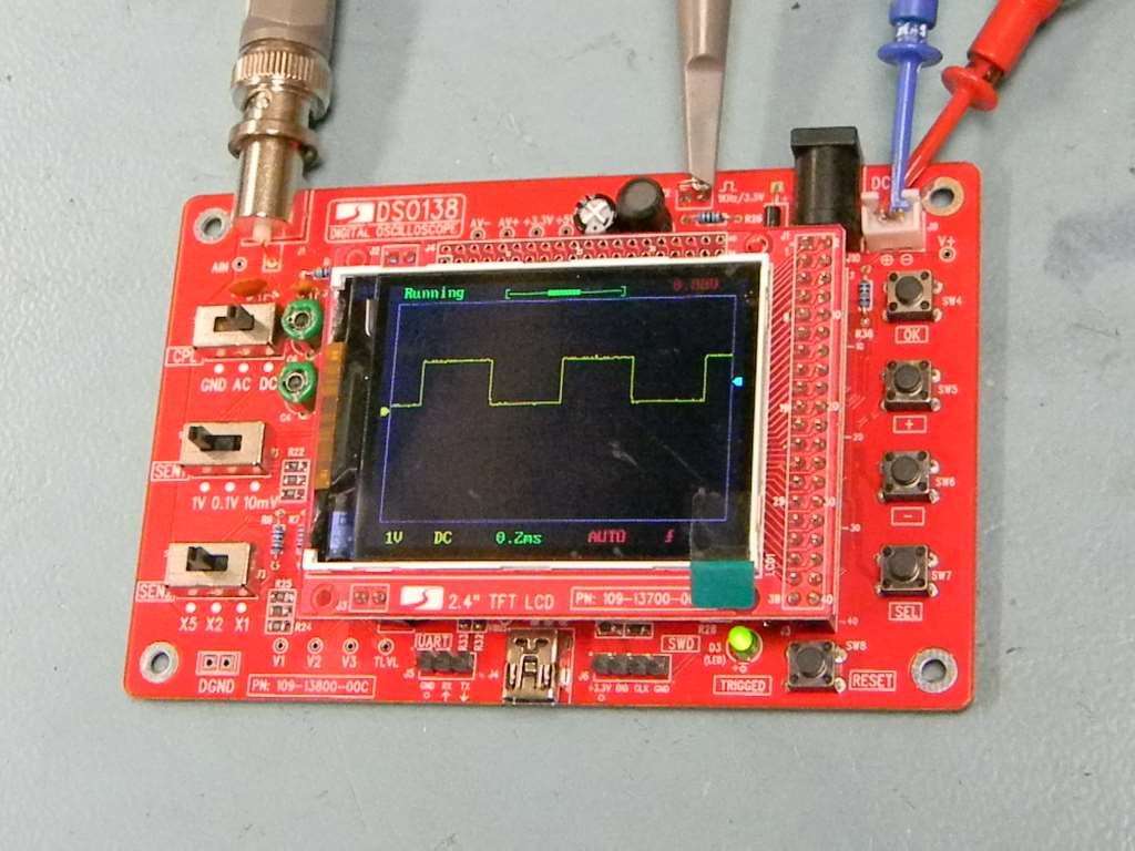

Here are a couple of suggestions for a cheap Chinese-made tiny o-scope. The first one was purchased as shown for about $50 in 2015. The 2nd and 3rd photos is for a kit for $14 in 2016. The first one is shown displaying the low-res Opti pulses. The second is showing it's own test signal. They only display one trace.

Thanks for the info I like the kit. I'll figure something out soon.
