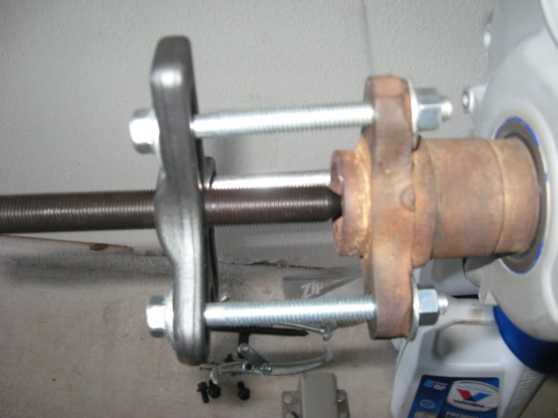

Here is how I pulled mine off. You need to use a 7/16 threaded rod to push against. I have unthreaded the crank bolt before and used that to push against but most advise against it so you don't screw up the threads. This picture was taken for someone else after I already assembled mine so that is why the crank bolt is tightened.
