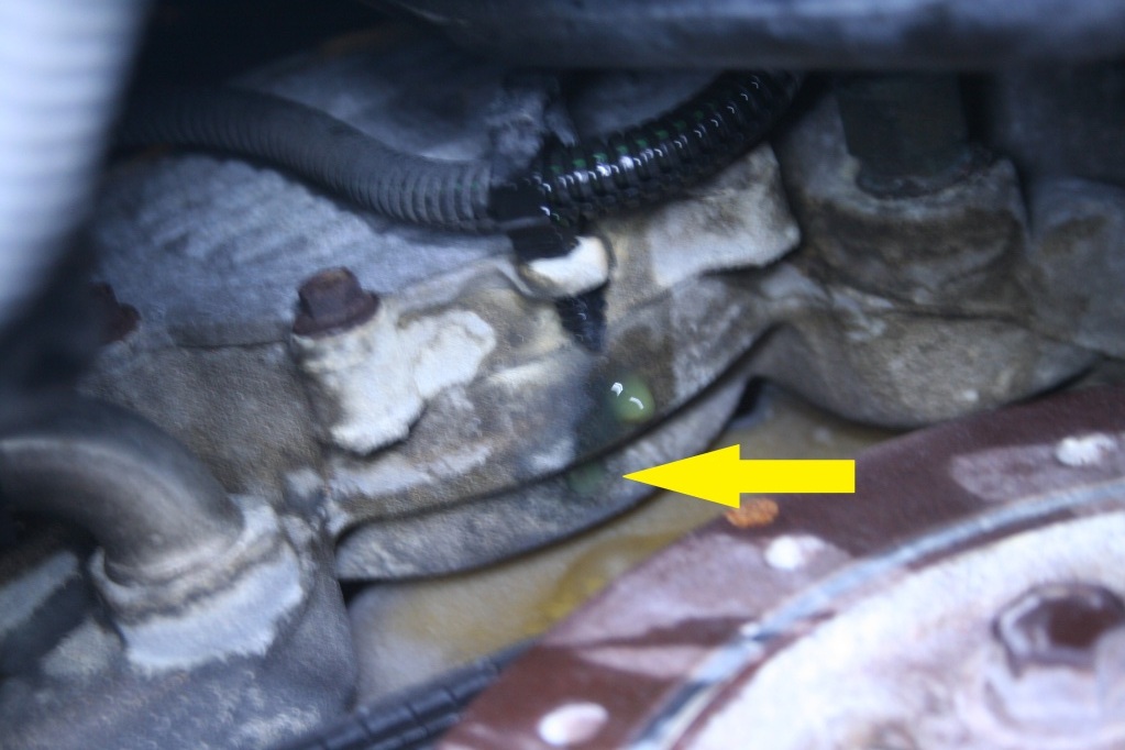

So, I parked the Z after picking up my kid tonight and went back out to tinker some more, only to find coolant all over the shop floor...
Put her up in the air, started it up....no leak....until it got warm then it started puking out from the weep hole on the bottom of the water pump. (see pic)
Am I looking at a new WP here? and if so, should I just go OEM or A/M or electric or what? I humbly await your expertise here...

No way to avoid it...you need a new water pump. Change to a stock replacement and you'll be fine.
Don't run it ike that as coolant leaking onto the distributor is a good way to kill it.

Yea, I've read a lot of the "wet opti" horror stories, I have no plans on dunking that thing in coolant.
I was pretty sure I needed the WP, but wanted confirmation before shelling out any dollars to get one. My local GM parts guy is starting to love seeing me come in the door....

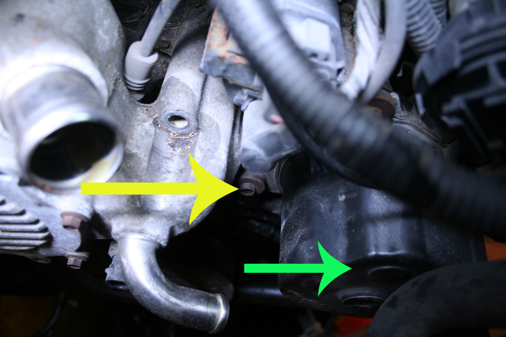

So, I have 5 of the 6 bolts out...having trouble locating the last one.
Is it the one indicated here in yellow? If so, it's also holding on the bracket for whatever that black cylindrical thing is indicated by the green arrow.
A little direction from the experts if you please...
Normally I would just look at the new one to find out, but it doesn't arrive until Monday...
Thanks for the help again...

Yep, the stud that holds that Air Injection Pump on is the last one I was looking for. It's on the bench now. sensor out, gasket mating areas cleaned up, bolts cleaned, waiting for a replacement...
