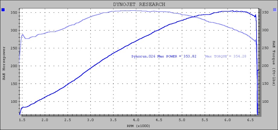

The 210/224 or a small cam is good if you don't want to tunr RPM and you have a small converter on a A4. Then it's AVERAGE power is decent for that. On a M6 or a4 with a 3500stall that you want to turn to 6500rpm you are going to get much more average power if you get a bigger grind or a custom cam. Just had a stock headed car get 350rwTQ from 3300-4800, with 350rwhp to boot and that would sure do better than a 320-330rwhp motor with 350rwtq.

Now you're talkin'! I have the cam Bret is referring to above and it averages more than 340 RWHP between shiftpoints. Since anything less than that (the cams you're talking about would be a lot less) would make the car slower, I'd have to say it "matches" the stock heads pretty well. While your application is slightly different, I doubt you'll find cams as small as the ones you're talking about will be optimum unless you have other requirements that call for them (such as not wanting to spin the bottom end past 6K, etc).

Yeah Jon has some good points, the are under the curve where the motor runs is what is important. Beyond that the faster (higher RPM) that you turn the motor is going to help since you can stay in lower gears longer and get more multiplication of the power. My father (Old Stroker) and I look at it slightly different but it's esentially the same thing, he likes average TQ I want the most average HP in the RPM band that the motor will run. So if you turn the motor higher you can go faster. It's simple but that's the main point.
Now the camshaft has a big deal to do with where the power occurs and how much is in the RPM band your motor needs to run in. With a 3500stall and a A4 that you shift at around 6500rpm, you have to look at each gear. 1st has the largest spread 3500-6500, then 2nd has 4000-6500 and so on. So getting a camshaft that focuses on below 3500 is pointless because the motor never sees that at WOT. The reason I'm not sure this cam is right for you is because the 210/224 is about two steps smaller than the cam Jon has in his car, and that one makes the perfect TQ curve for your application. Beyond that if a cam that works in a M6 in 6th gear with a 4.10 gear compares to a A4 in 4th gear with a 3.23 because you would have essentially the same RPM at a given mph.
