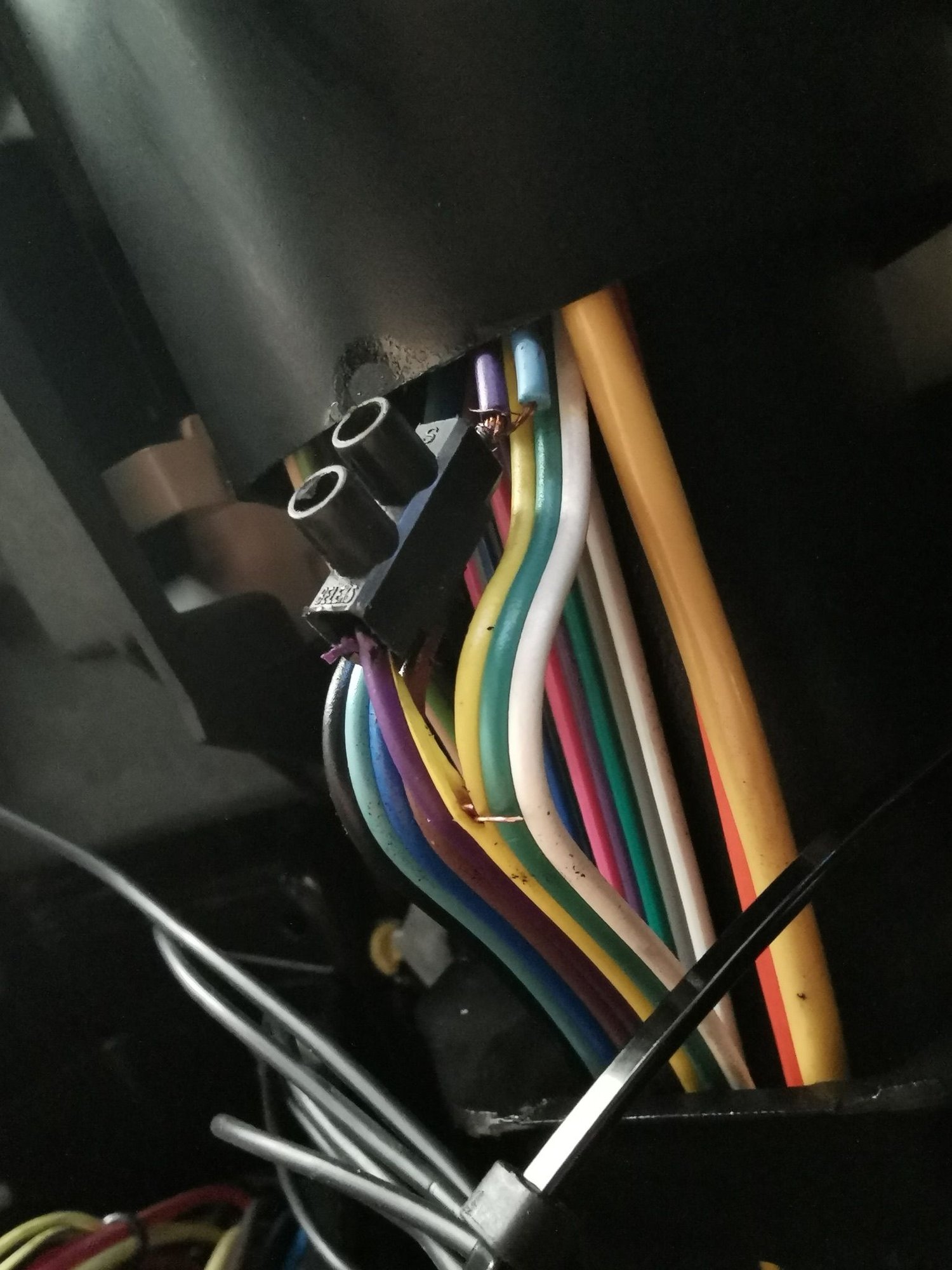

could this be my problem? looks like yellow spliced into purple and the turqois without connection...?

Are you asking if that is related to the SES light? Is that on the steering column - I can't tell where it is located? The wire from the PCM to the SES light is brown/white. It passes through the firewall in pass-thru/grommet P110, which is right behind the PCM. It runs to connector C230, which is right behind the firewall, to the right of the HVAC blower motor. I don't think that wire would end up in the steering column.
That may just be a plastic splice maker.... If you look into the two seemingly empty "holes", are there slotted screws in there that are used to tighten against the spliced wires? Doesn't look "factory", and they wouldn't do anything that sloppy.

lol! sorry! I was working in and out of the car and saw this „piece of art“.
later, when I was already in bed I thought that this is surely not related to the ses-light.
but I took out the gauges one more time and tried to measure the current. on C8 it only showed about 3V where on others it was about 8V.
