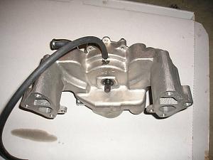

You may want to consider doing the weep hole mod the next time the pump is off.
Ill look that up, seems like a smart idea.
