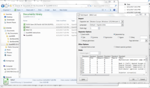

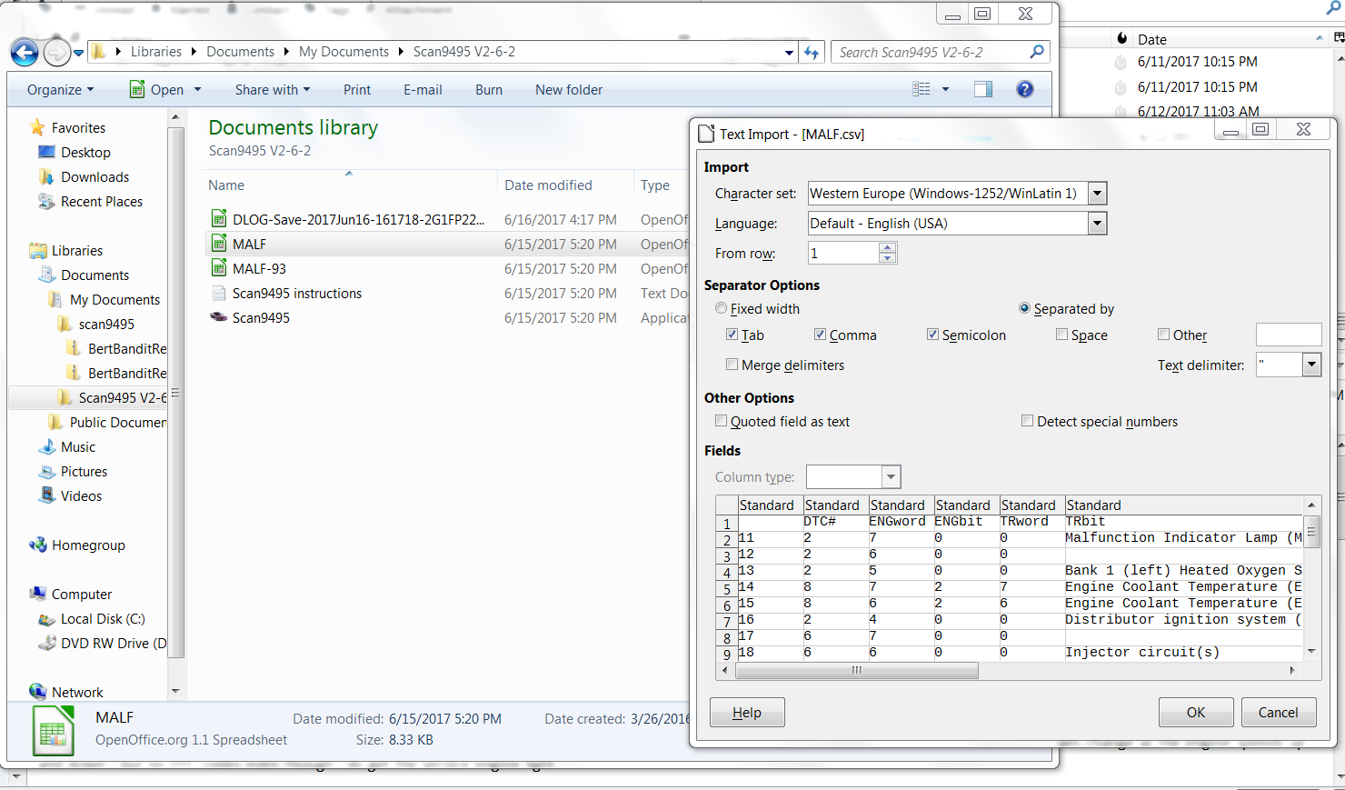

Gary, I sent you a screenshot of the files in the folder as well as the content of the mail.csv file. No problem with the PC. The data is also changing on the 9495scan screen when the engine is started. Still no DTF codes, and no change in the way the engine runs. No PC errors. I and going to try and get the PCM to throw a code tomorrow, but as many times as I've tried it already, I am pretty sure it would have already thrown a code if it was going to.
