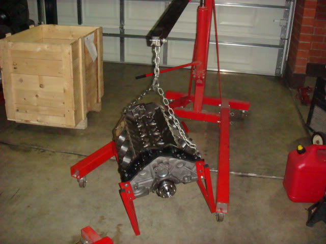

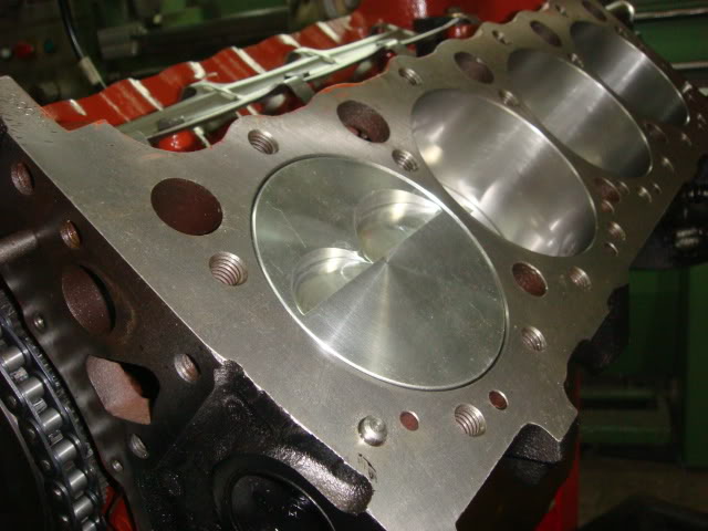

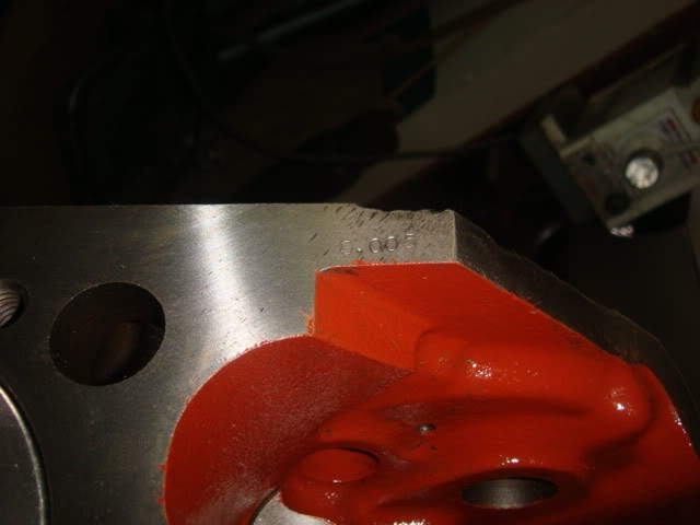

I have a VRE 396 shortblock with an LE3 TRICKFLOW heads & cam in my 96 Camaro.
It was built for NA. Decked, Flat top Diamond pistons, Callies crank, etc.
I have nothing but good things to say about them.
I dont use it as a DD though, but it is no trailer queen.
