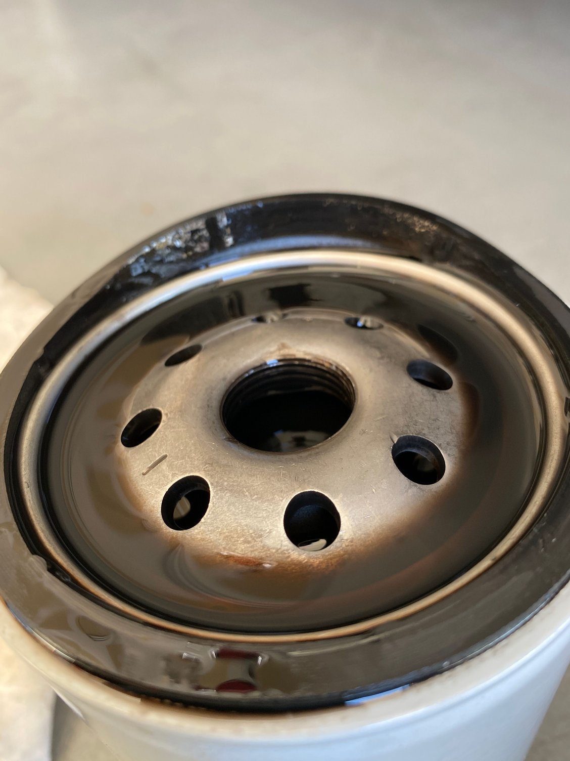

I located the issue this morning, see the below picture. I had this issue when the build first when together. The guy I was working with convinced me that adding a shim to the oil pump was a good idea to increase the oil pressure and flow through the engine. Anytime the engine was over 1000 RPM, the filter would blow out like this. I cannot at any point recall seeing the oil pressure over about 1/2 the gauge. There was almost no oil in the pan, but there was a small amount of metal on the magnetic pickup.
What advice would you give? I am buying another short block from a member this weekend, but if this engine is still okay, I will likely keep it crated until the next stage the build. In my mind, something had to cause the pressure to build high enough that the filter seal blew out. Outside pulling the engine for forensics, is there anything else I could do to determine what happened?

Never seen that happen. I run 80 psi high flow and never had a problem. I would get a better filter and and just monitor it.

This was a K&N, what would you recommend?

What oil pump are you running? Stock pump has a 60 PSI relief spring. White spring gives you an 80 PSI relief. Oil filters typically have a burst strength in the 100's of PSI. Might be worth pursuing with K&N.
Could you take a picture from the other side, and from above?

I would put a WIX (NAPA Gold is same) filter on and start/drive the car. You may find this is just a "weird" issues with a K&N filter. They are high $ filters...more because them supposedly offer "better" filtration (not saying they do) but IDK if their construction is any better than other filters
You mention "spacer" in the oil pump to increase pressure and you had this issue before so I assume you removed that spacer??. typically a spring (color) change would be used to increase "pressure".
Do you have a HV oil pump with stock bearing clearances?
You also noted you deleted the oil cooler...IDK if that would have anything to do with this but I would think it would not
You still had oil in pan and some shavings on the magnet, was it very fine dark almost "fuzz" or clearly "metal" shavings?

More like fuzz thank shavings or slivers, very small in size.
as for bearing clearances, I am not sure. The build was handled for me, mistakes of a kid... I think it is a high flow pump. Yes the shim was removed.
Ill grab the requested pics in a bit Fred.
