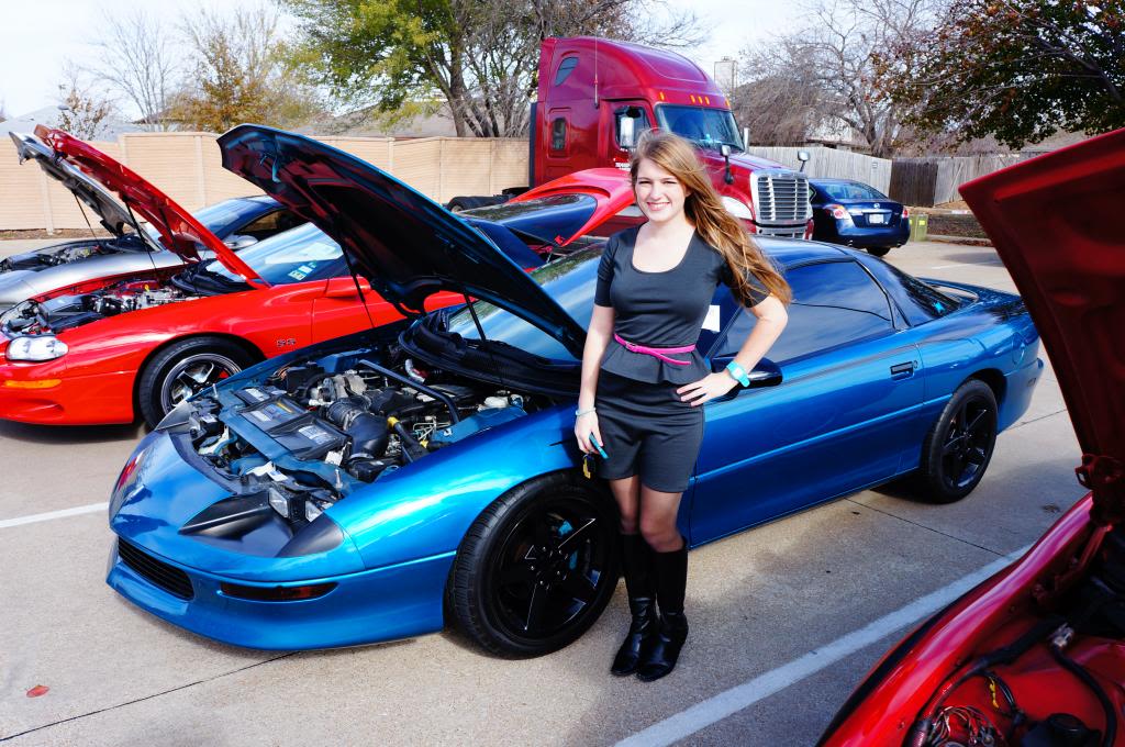

Hey everyone, Im making this post for my GF. She has a almost completely stock 94 z28, only thing that is not stock is deleted cat and cutout and appearance.
She wants to put a cam in it but she doesnt have alot of money to spend on her camaro and is a full time student.
I tell her that bolt ons would be better to do than straight to a cam swap but I think she is gonna gather parts and do it all at once like I did.
She got a almost brand new CC306 camshaft for $50 that she wants to put in her Car.
Ok now the questions
Whats the cheapest safest way we can put the cam in the car.
Whats the best budget springs for the CC306? Gonna keep stock rocker arms, lifters and pushrods.
She will need a converter for that Cam. yes? She wants a yank 3600 like mine lol, but thats like a $1000 right there.
For the CC306 will she need gears in the back other than stock?
Mail order tune should suffice.
It would be an interesting test to see how a legit "CAM ONLY" lt1 would preform. And im talking Cam only lol, no CAI and Manifolds. But I think she will gather all those parts.
I honestly think the CC306 would be better off in my car and she would be better off with my Cam (CC503) but I dont feel like taking 2 cars apart to swap cams.
Heres the car,

Nice car...nice gal too

Agreed, very nice looking car and a lovely lady to. There has to be a better cam than the 306 for her. I think she just wants a chop in the idle so wouldn't a 503, AI 226/234, or even a hot cam do that for her and be better for the use with stock heads?

Well I'd just like to say your car looks fantastic. So of course you gotta have the power to back it up
