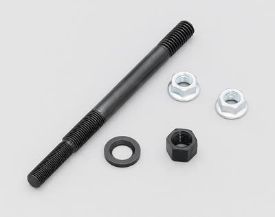

Hey guys, I have my shortblock on the way from the member I purchased from, and looking at the ARP studs that were used on the mains, it was setup for using an aftermarket oil pan, they are definitely too short.
Looks like I need to remove 3 of the studs and replace them with these?
http://store.summitracing.com/partde...115&rsview=sku
If so, how do I go about putting the studs back in, not really sure how all this works. Remove the old ones, I believe they have a hex provision on the ends.. then put the new ones back in? Do you just thread in studs till they bottom out and tighten as hard as possible with the hex key.. then place the nuts down and torque to spec? (what is the spec anyways)... Is any thread locker used on the mains?

For the record, the milodon studs appear to be made by ARP.
The nuts are all stamped with ARP and the stud run the same tensile strenght even though they don't have the ARP marking.
If you decide to go with studs do the following.
1. Cleaned all the new studs with break cleaner or lacquer thinner, doesn't matter just get the glue from the package off.
2. Removed 1 original main stud from 1 cap. (Replacing one stud at a time)
3. Dipped block side of the new stud in 30w oil...only up to the top of the treads. (The milodon studs give you the torque spec for oil but moly lube could be used...not sure what the torque spec would be.)
4. Install stud finger tight in block.
5. Wipe 30w oil all the way around the top threads for the nut.
6. Torque the nut to 65 ft/lb per the Milodon instructions.

You'll have to ding the stock pan a little to clear the studs you are planning on using. I used the Milodon diamond stripper with those studs, little clearancing is needed, but nothing anyone can't handle.
