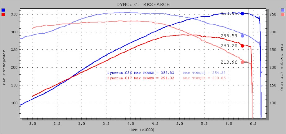

Originally Posted by Texas_96_Z
Ok so I have decided the next major mod will be cam and valvetrain. So my question is: What is the nastiest cam I can run with my stock (will be ported later) heads? This is a weekend car so I don't care about gas milage, ect. This will be a slow parts build up (married with kids). So LE1, 2, 3 or custom grinds are not feasible at the moment. Remember, I will port the heads later on down the road.
Thanks in advance for your replies.
It is possible to get a lot more from an LT1 without ever removng the heads, by just changing the valvetrain with the following considerations:
1) You'll need supporting mods like headers, free flowing exhaust, retuning and perhaps even different injectors, and a gear that will let you rev.
2) To get more torque and power from say 3500-6500 you'll have to sacrifice some below 3500, where you probably do much of your driving. You might want to limit revs to around 6500 on the stock shortblock.
3) Valve motion will be a lot more aggressive so you'll need better lifters, pushrods, rockers, springs, and retainers. This is over a grand in parts to accomplish this. If you didn't get all the right parts it won't work, nor will it work very long.
4) What could you expect for power increases? Perhaps 40-50 hp at peak and as much as 80 hp @ 64-6500. That's only going to help if you run the engine up there.
5) Here's an SAE Dynojet comparison of just what I've described. It's nearly 3 years old now, so there's probably a little more to be had today. Not everyone will believe this, but that's ok. You have to dot all the "i's" and cross all the "t's". IOW, you have to do everything right.
http://www.jonaadland.com/NewPics3/Camdynocomp6400.JPG
6) Would I advise you to spend well over $1000 plus installation/tuning/headers, etc. this way? Not really. I'd do the headers/exhaust, etc which you'll need anyway when you can do a head/cam package in the future and get more increase.
FWIW, I don't think this cam was all that "nasty". Rather it was pretty much what the engine needed to get where the owner wanted to go. Bigger ain't always better.
