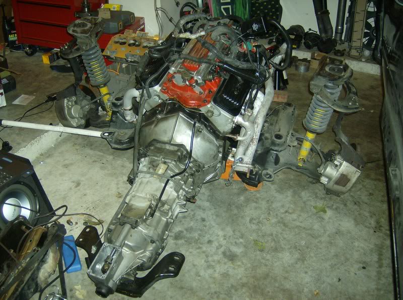

They will come out of the top or you can drop the engine, suspension, tranny and all accessories easily out of the bottom in one piece. They will slide out from under the car like this and it's way easier to take them apart...
I've pulled/installed both ways and if you are going through the top take the trans out at the same time and just pull it straight out. I actually put my BBC in the Trans Am that way. If you are against that then the picture above is worth a 1,000 words
I've done it both ways, I really prefer the bottom, man is it easy to put headers on standing next to the engine. Actually when I do cam swaps now thats what I do
With the two post lift in my shop it might as well be in there with a zipper. Starting at 8am I have had the k member and engine/trans out on the ground in about 2 hours taking my time. The first time I did it i took the harness and computer out with the engine. Ef that just unhook the harness from the engine and drop it out. Takes me longer to fight the harness and get the pcm connections unhooked inside than it does to just unsnap connectors which have to be removed anyways.

I just did my first engine/trans removal on my Camaro and it went great! I did it out the bottom by myself. I have a mid-height full car lift (using jacks points on the car). I bought a 1,000 lb rated capacity hydraulic platform for the engine. I set the platform at 24 inches high, supported the engine/trans, removed bolts, raised the car to top extreme of my lift and rolled the engine straight out on the cart.
I didn't have to mess with multiple jacks this way.
