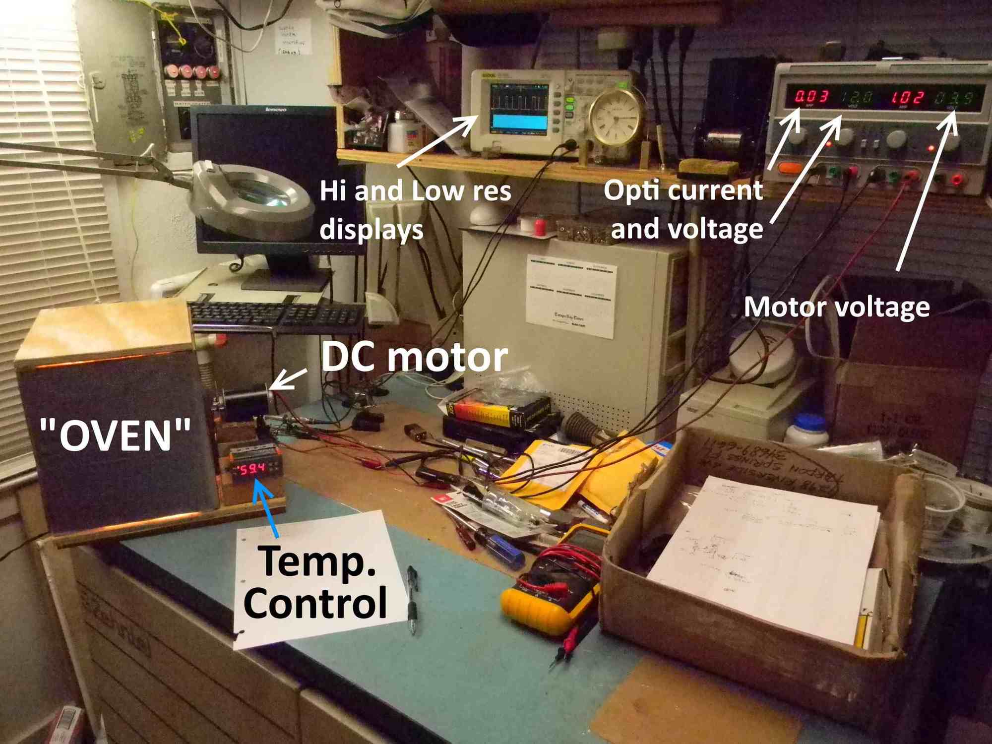

45 year electrical test engineer here. A photo of my Opti test setup in 2015. The Opti is mounted in the plywood box. A DC motor is used to spin it at varying speed: A 150 watt incandescent light bulb is used for temperature setting and a temperature control keeps the temp at a preset level.The supply current and waveforms are monitored continuously. A PC is attached and will log the time of loss of either Hi or Low res signal, or dc supply current.

Hi GaryDoug,
Have you checked out what Berrington1 is doing with the opti rebuilds on eBay? What do you think?
The photo of his test rig will look familiar to you!

He is about 4 years behind me ;-) See this one in 2014 with a hair dryer:
And this post #10 in this topic in 2015 using a portable heater:
https://www.camaroz28.com/forums/lt1...talled-877594/
In both cases I found the heat soak to be inadequate unless the Opti was placed in a chamber. Otherwise the heat did not soak evenly. I purchased one very cheap Opti on eBay just for evaluation and it has held up so far to this type of bench test, but I would never use it in a real engine as that environment is far more stressful. In other worlds I don't think his test is enough. Nor is mine.
But I normally do not repair these. I have done only 5 so far just for friends. Only with one was I not able to repair it, and it was a real OEM version with a bad amplifier board. The amplifier board is hidden under the the metal plate opposite the optic sensor.
