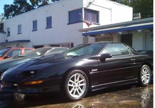

just want to see if it works
Old Jun 5, 2009 | 12:05 AM
sick9lt1's Avatar
Joined: May 2009
Posts: 175
ok and it dose i will post pics soon thanks man
