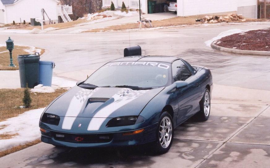

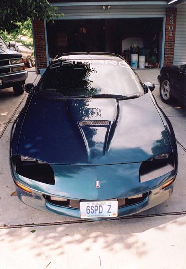

it is an aftermarket fiberglass hood, but matches a slp hood
http://www.jay91rs.cz28.com/images/z2.jpg
http://www.jay91rs.cz28.com/images/z20.jpg
the airbox is slp
yes the asr box sits on the drivers valve cover, kinda twordes the back, can someone post a pic of the engine of a 97 ss?
