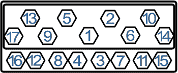

Don't tightened the stud down into the threads. Bottom them out then back them off 1/4 to 1/2 turn. As long as you are using the correct tightening sequence and doing it in stages I would torque them to ARP's recommended value with the given thread lubricant.

Did you follow the tightening sequence? I don't know what you would have done incorrectly if you followed that. Did you start at a low torque across the head then move up 2 or 3 more steps till the final pass at 85#?
I guess I'm not seeing what you would have destroyed
edit: Did you tighten them light this? Name:  sbchvy_head_seq.gif
