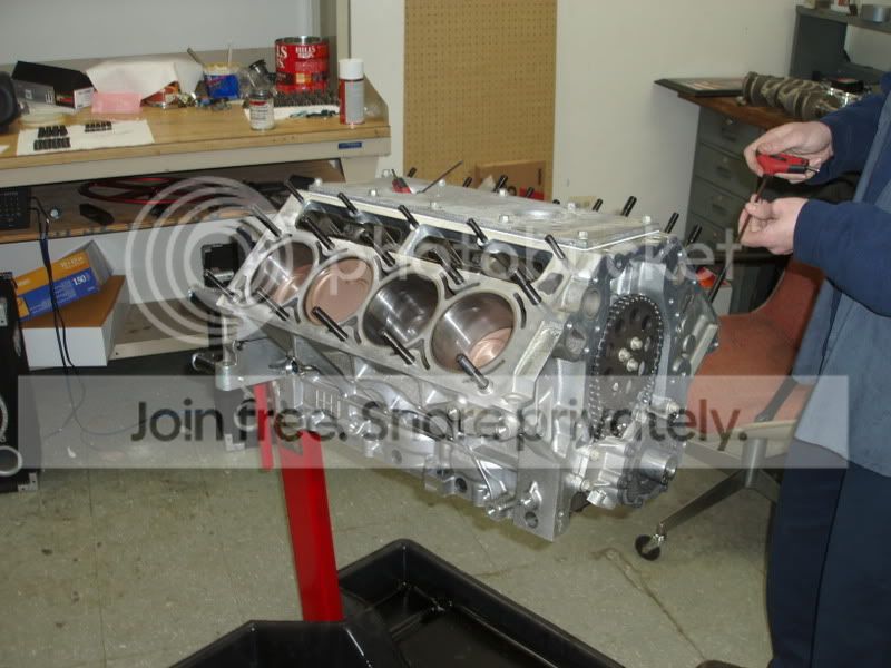

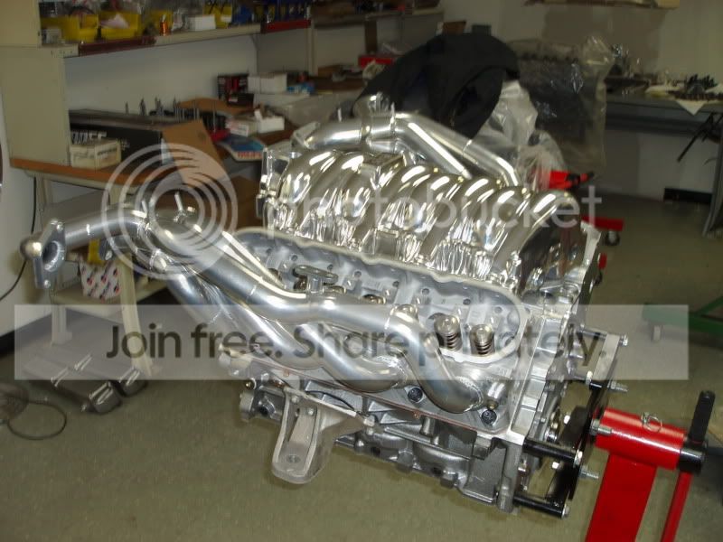

I am positive they are doing this. My info is from 70's dragracing legend Jerry Clayton. (Keeling and Clayton California Charger) They work on all my stuff. They are also a dealer for AFR. I am at their shop almost daily either working on my junk or watch them working on stuff. Example of the stuff they do.......

Pretty impressive!
