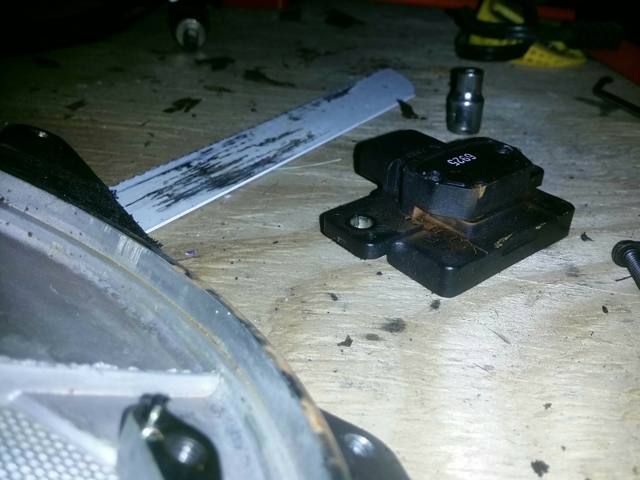

I tested everything all the wiring was fine it had to be the Opti I pulled it apart today and the sensor was rusted so I'm just going to order a remanufactured GM one and hope for the best
Attached Thumbnails Advice about no spark probably opti ?-cymera_20160317_182428.jpg
