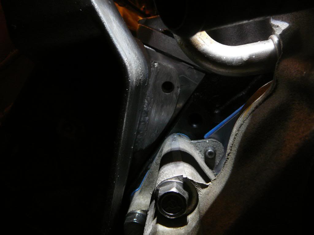

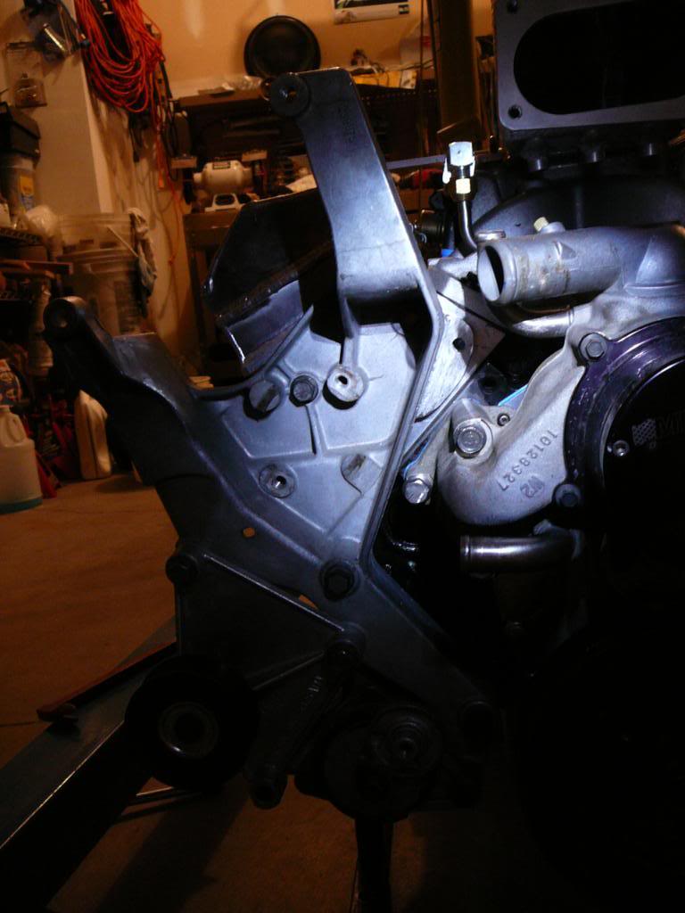

I ended up welding a tab to the accessory bracket that lines up with one of the existing threaded holes in the head and all it solid now. Here are some pics for any future reference.

That tab may not look very structural, but it is just as strong as the cast accessory bracket.
