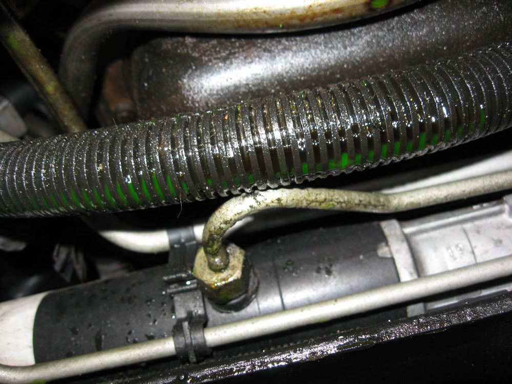

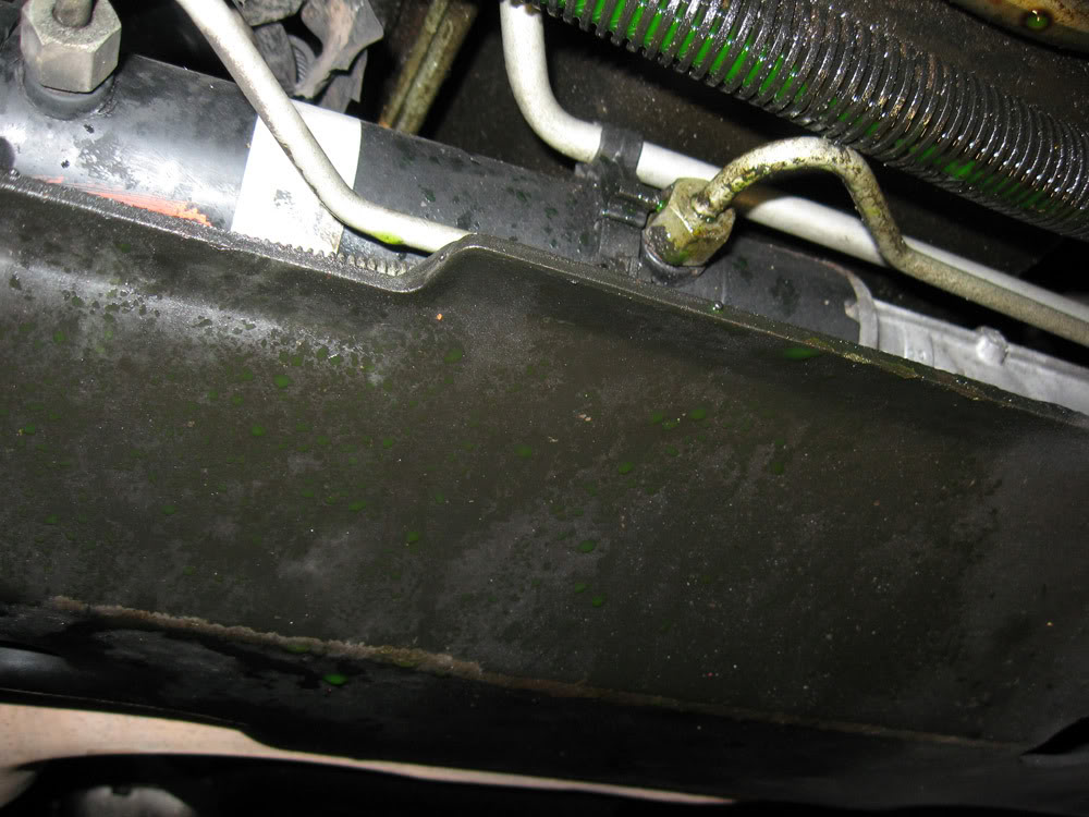

Something is leaking all over the steering rack, whatever that bundle (of wires?) is underneath the plastic sheath, the metal that scapes on speed bumps, and that suspension tube I don't know the name of.

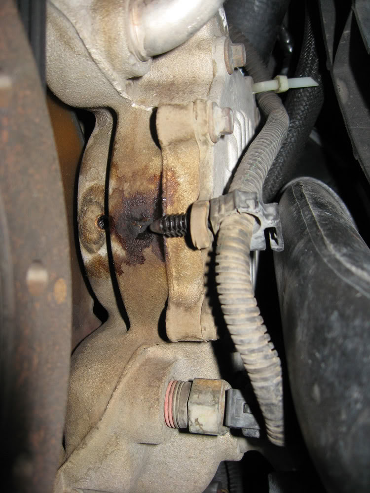

I checked the water pump, and being the extreme amateur mechanic I am, I can't conclude anything about what I see. It looks like it's been weeping, but I wiped it with my glove and it's dry and nothing came off but black soot. Does the water pump get hot enough to evaporate evidence of a leak? Is this the source of the leak?
The power steering hose on the rack doesn't seem to be leaking, and we had this replaced last year, so it's pretty new. Since the intake manifold gasket has been leaking slight amounts of oil for nearly a decade, it's hard to tell what oil is what.

The staining around the waterpump is a good sign it's leaking. It may not leak all the time, perhaps only under pressure.
Fix the gasket on the petcock valve and replace the water pump.
Also check the water neck and upper hoses, like the throttle body hoses (if you haven't done the TB bypass), heater hoses, etc.

Yep - 100% it's your water pump going out. That stain is dried coolant on the bottom of the waterpump where it is coming out of the wheep hole. Change it now as prolonged it will eventually kill the opti as well.
BTW - that suspension metal tube (LOL) is your Sway Bar.
