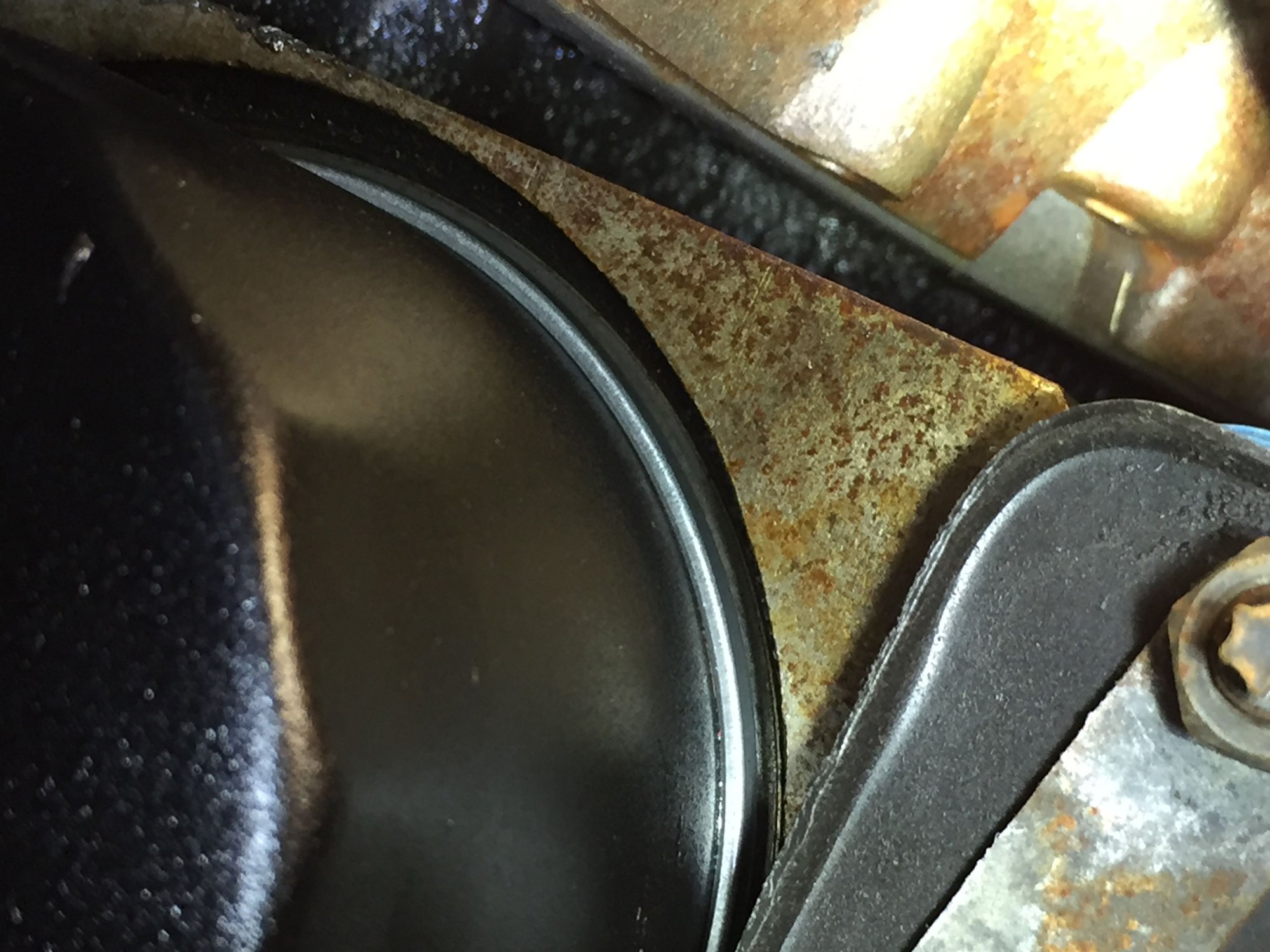

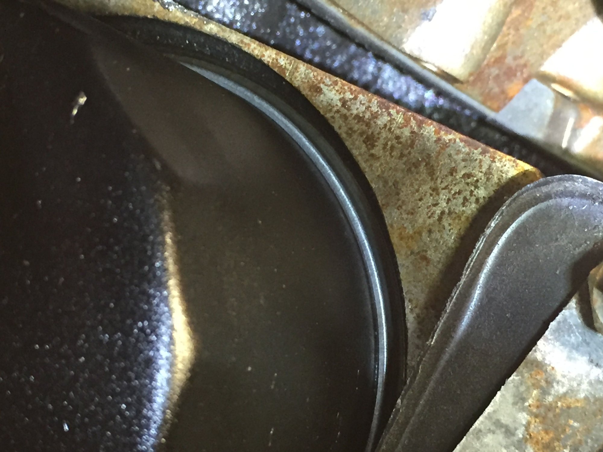

Hey guys I was getting ready to lift up the motor when I saw the ring around the flywheel that the starter uses to start shift I don’t know if that could be a problem? And it’s raining so can’t do anymore today.

Also the show of movement shows in all 4 openings on the flywheel in equal length about 1/4 to 1/2 inch and by shift I could NOT get it to move personaly
