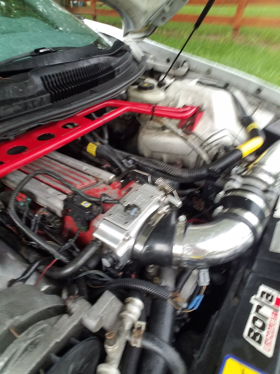

heres a picture of my setup,
whats the plug go to that I have sitting on top of my throttle body

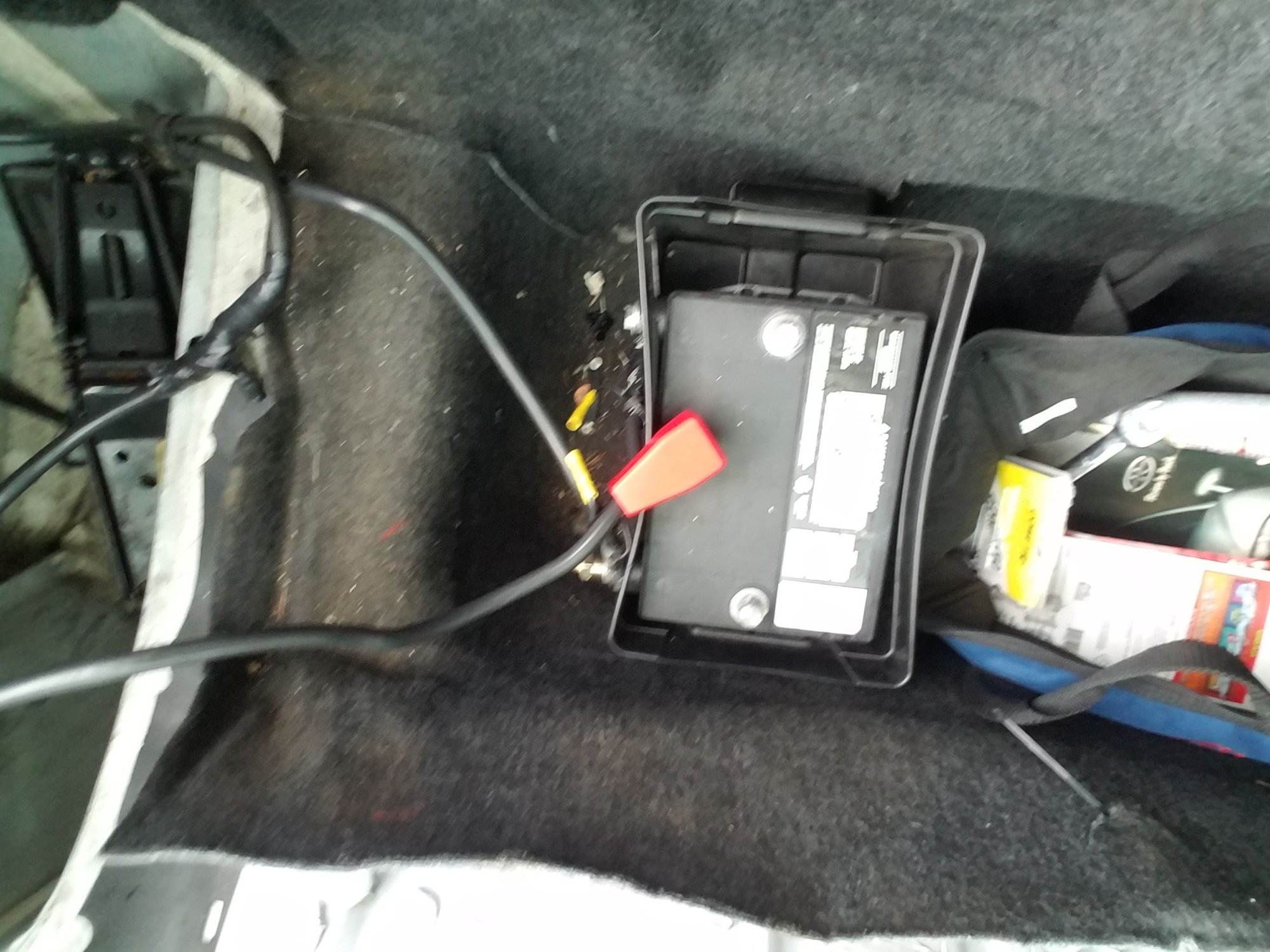

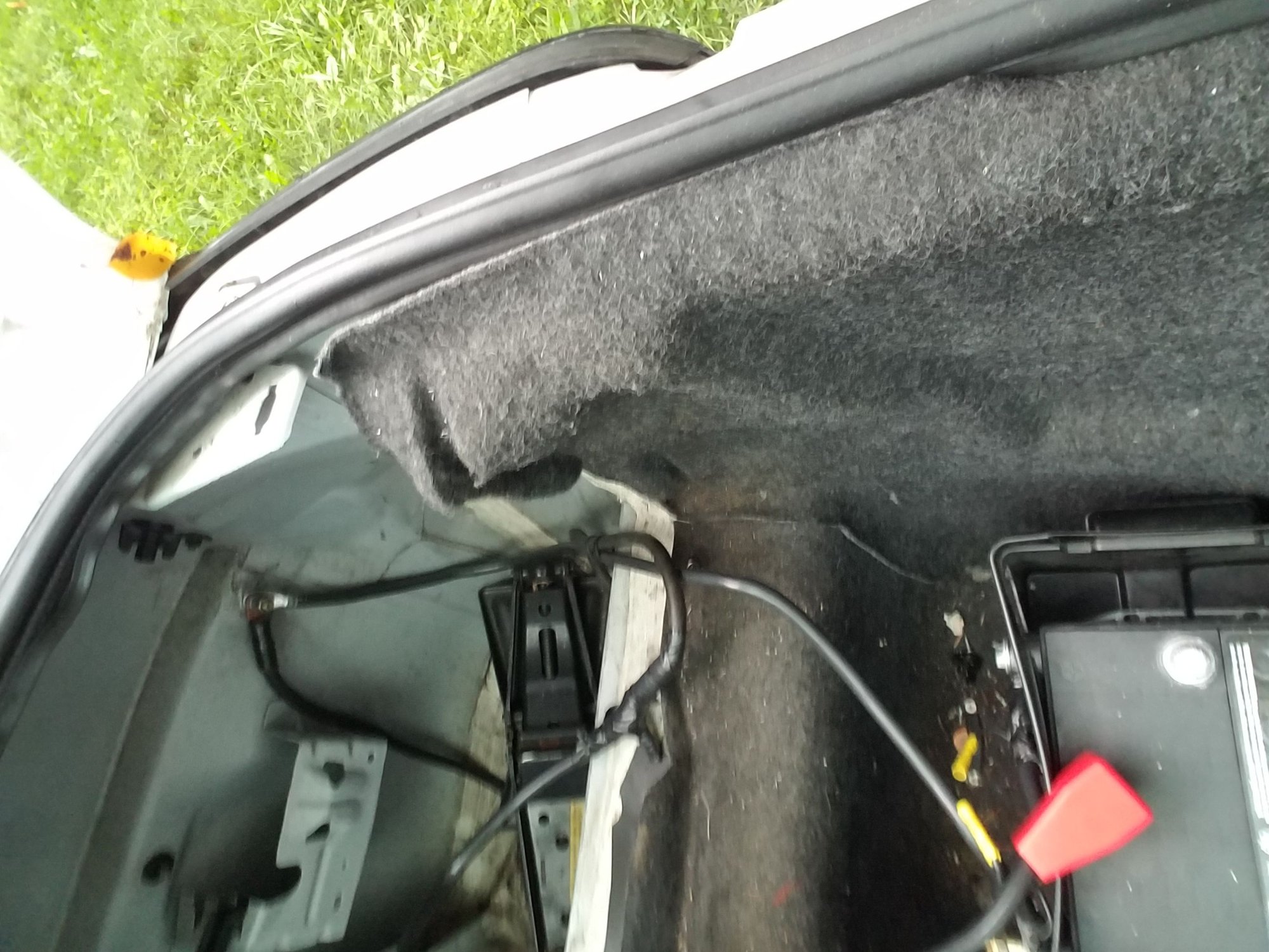

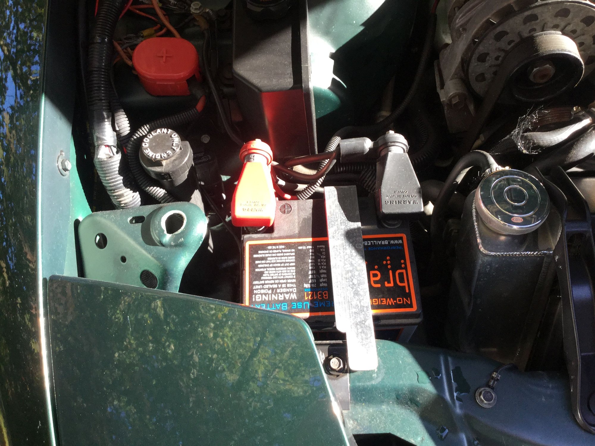

Are you running two batteries - one in front and one in the hatch? Is the battery box fastened securely, and vented? Rear mounts can be a major problem unless done correctly. I just went with a light weight battery up front to avoid the problems.

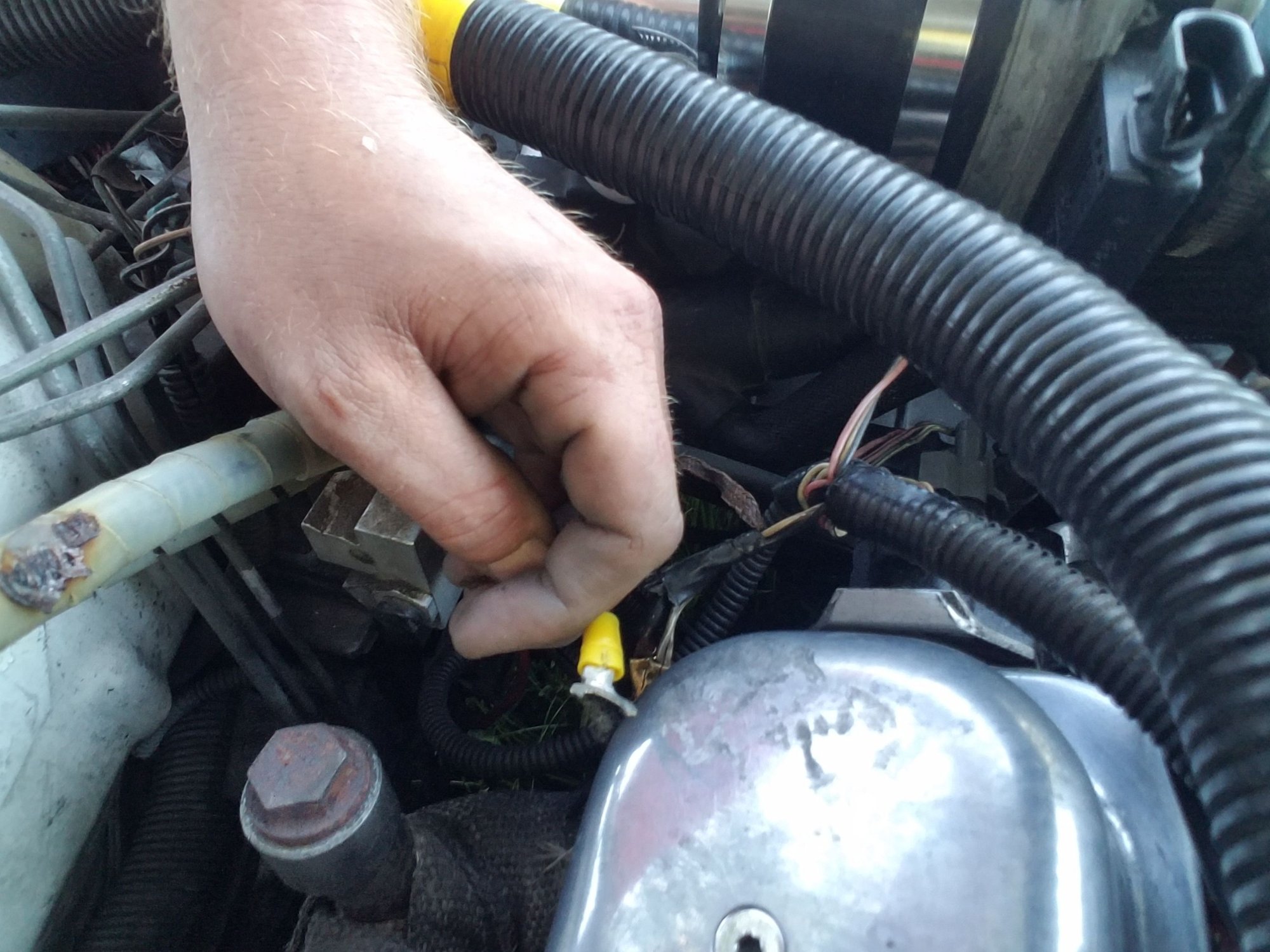

yeah im running one up front and one in the back, it seems to be wired up and ran really good(i didnt hook up the rear battery until just yesterday, so my problem was well before i connected the rear battery) i think i found my problem :fingerscrossed:
that grounds to the front of the block along with the injector wires and then into the frame frame

also do you know anything about that plug thats laying ontop of my throttle body(in the previous post)does it go to anything? and I wanna thank you alot for the advice for sure.

Picture of the connector is fuzzy, and I don’t recall any part of the stock harness being that long. Appears the harness bundle has a random red wire poking out running toward the alternator.
looks like the ac compressor connector
