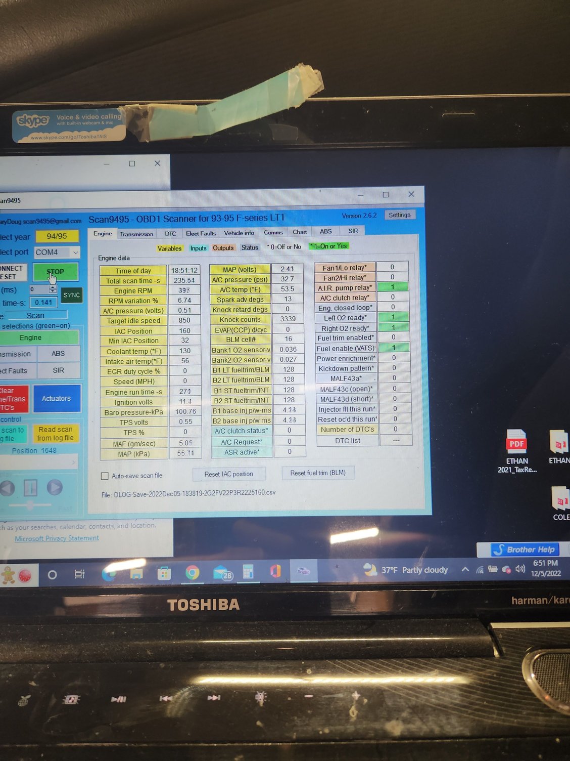

Not much stands out in the screen shots. But screen shots do not provide the insight that a correctly run data log can show.
Idle is way low and the IAC valve is maxed out open. High MAP probably due to misfires.
At idle the long term fuel trims (LTFT) are adding an appreciable amount of extra fuel, but misfires can cause that.

New scan - engine kept stalling til warmed up. Then ran noisy and no power. I have more scan pics just didn't want to put in to many. Also Added Pics of voltage from injectors

The high MAP readings (~50+ kPa at idle, vs. a typical value of ~30+kPa w/ stock cam) could be caused by a plugged catalytic converter. That has to be diagnosed by hooking a pressure gauge up to an O2 sensor bung.

On Scan9495 where does the RPM's come from? is the computer getting it from the Opti?
I see on one of the pics it showed 'Engine RPM' 420 but "Target Idle Speed" 900
420 RPM seems real slow, is that true RPM or error reading?
Thanks!

The PCM reads RPM from the Opti cam position sensor pulses. The PCM controls the RPM using the idle air control (IAC). As I pointed out in post #3 the idle RPM is way low compared to the target idle, and the IAC is maxed out at 160 counts. First thought might be that the engine is starving from air, but the high MAP reading (50+ kPa) is possibly due to misfires, preventing the IAC from controlling idle.
Fortunately Shoebox pitched in with the comment about a plugged cat. Could cause the high MAP, low RPM, and loss of power. I overlooked that possibility, instead suggesting it is a timing problem.

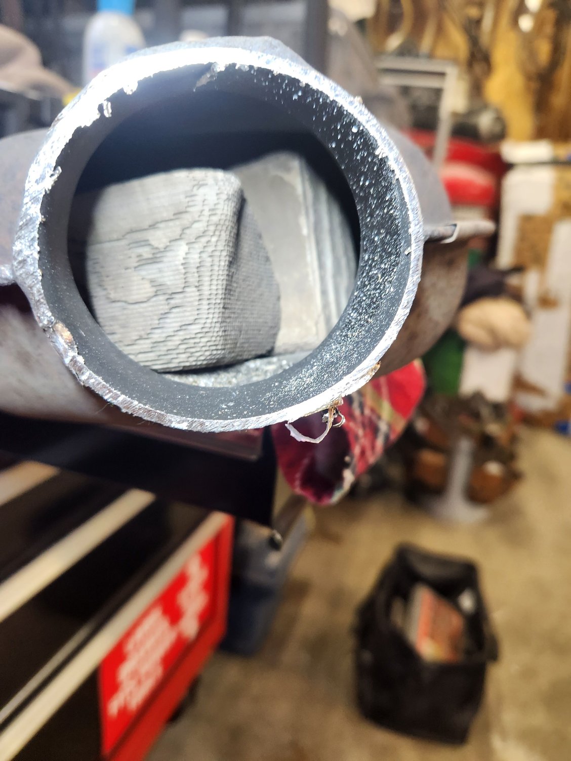

Well here it is. Bad catalytic converter.
I'll post once I get it back together.
