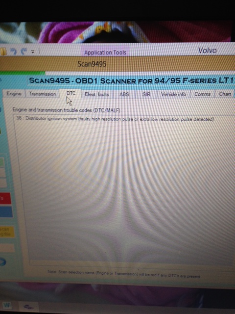

Fuel pressure stable at 32-34psi. A bit low, problem? New version of the same fuel pump I have used for 6 yrs. Engine ran rough right away, would barely rev, multiple DTCs (including low res pulse on opti):
Cleared DTCs, restarted engine, got only 1 (opti again, high/low res pulse):
