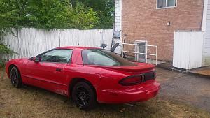

I finally uncovered my Firebird after a very long northern Michigan winter.
I swapped out my Camaro rims for some old school t/a rims and bigger tires...looks pretty cool to me (posted photos for before after).
Finally replaced my coolant sensor (on water pump)...and would you believe it...started up everyday now and ran just fine!!!!
