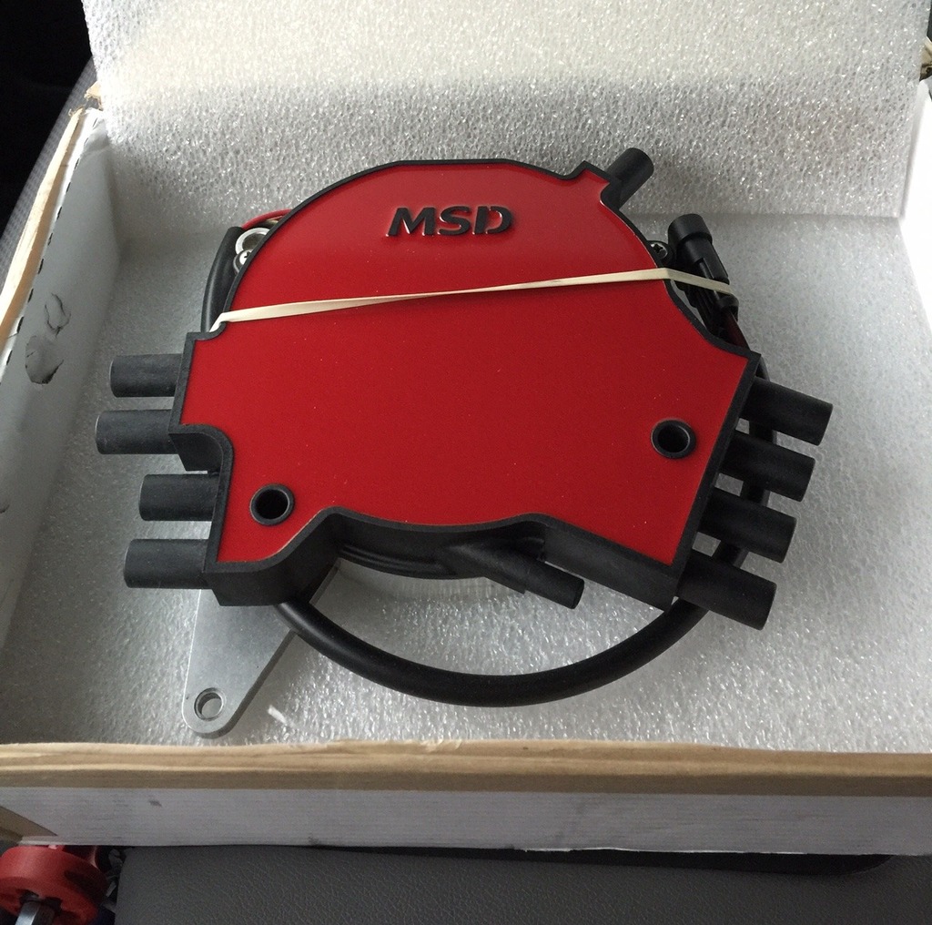

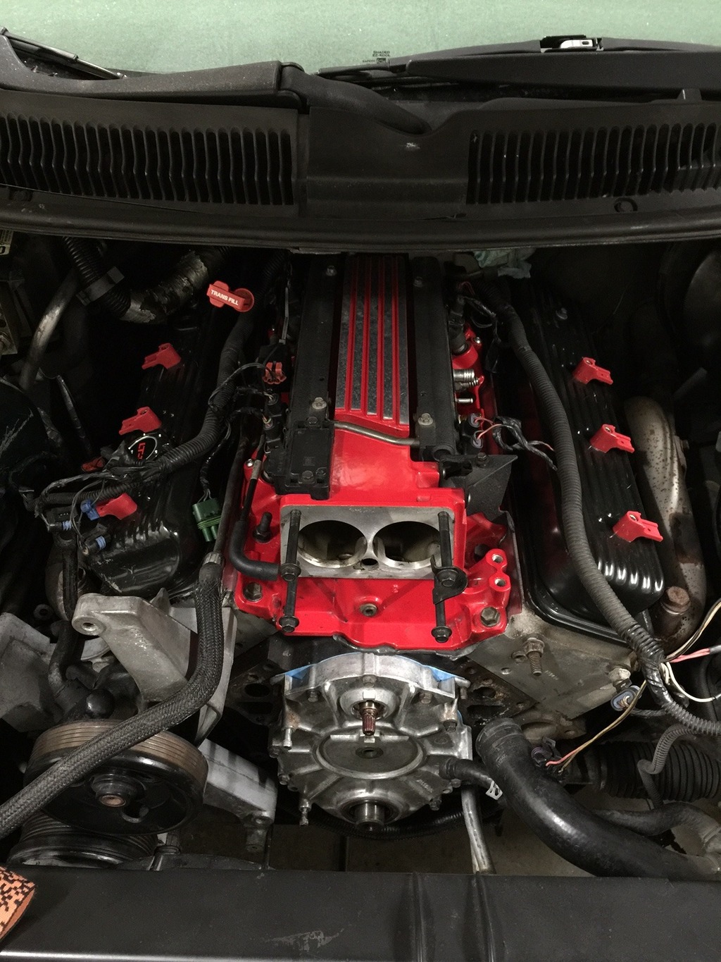

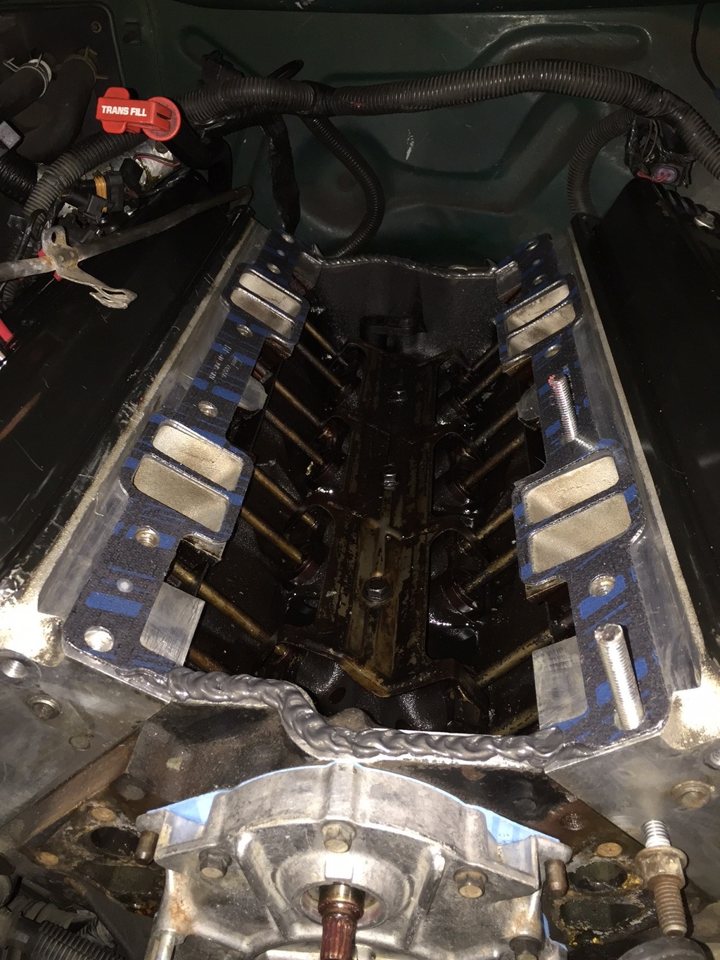

I've made some headway on the car repair. I got the timing cover/gasket installed, new oil pan/gasket installed, oil cooler re-installed, starter re-installed, intake manifold installed & sealed, and received MSD rebuilt Opti.
MSD rebuild was awesome. They replaced the opti sensor, encoder disc, center o-ring, and new cap & rotor. The total repair cost was $68 with return shipping. I couldn't have even bought the cap & rotor for that cost.

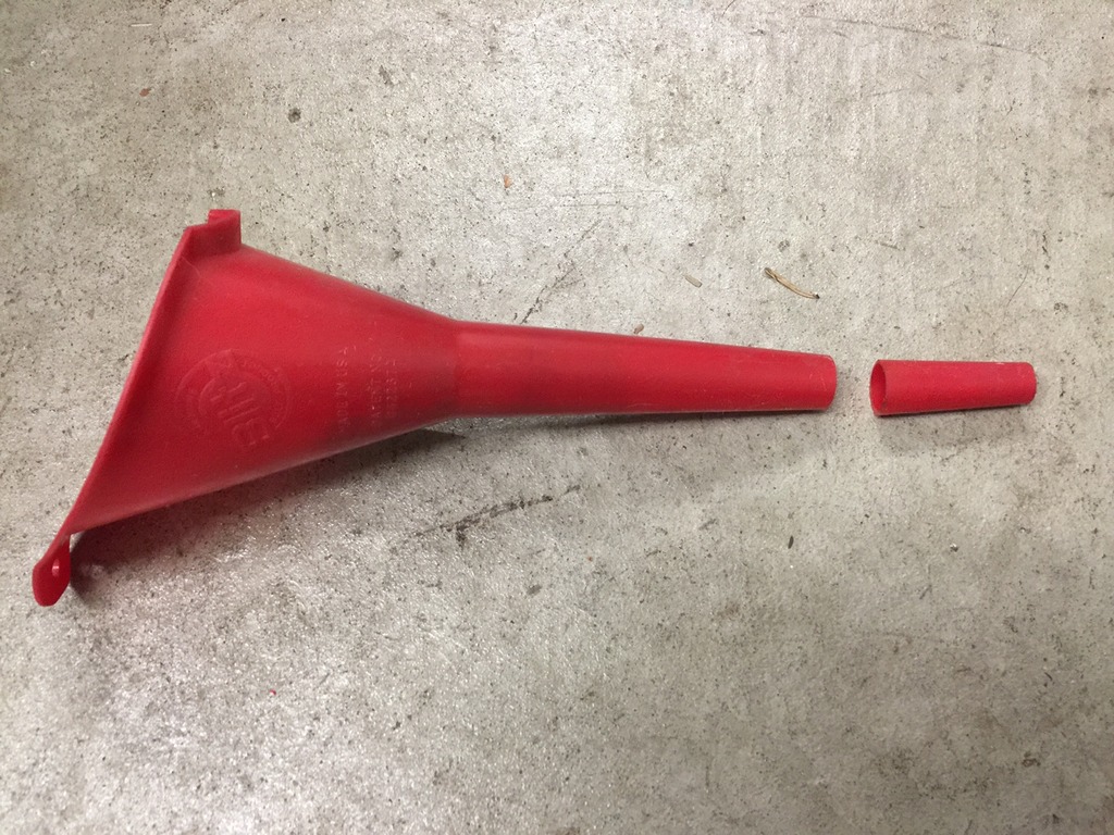

I've been thru 2 water pump drive seals before I successfully installed the third seal. I didn't have the nice aluminum install tool. The first seal was trash because I installed the seal before installing the timing cover. On the second seal, I used the 1/2" deep well socket (1/4" drive). I'd seen a YouTube video where a guy had used this method. This didn't work for me. I started looking around the garage for a tool substitute. I ended up using a transmission funnel. I measured the OD of the water pump drive and cut the funnel where it matched the OD. This worked perfectly!!
