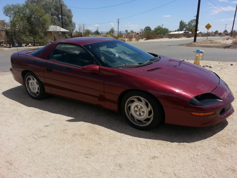

Hey everyone,
I'm new to Camaros and wanted to start a build thread to track progress and allow input from the knowledgeable users here to get me on the right track.
The Basics:
B4C: LT1 and 6 speed
84,000 original miles
Lowered 2 inches with Eibach springs
No cat or real exhaust and no o2 sensors
Hurst shifter
Maroon in color with a black stripe
The Bad:
-SES light on
- Ugly color
-Low coolant light on
-Gas gauge is off by about a 1/4 tank
-Ride is pretty rough
-Ugly C4 Vette wheels need to go

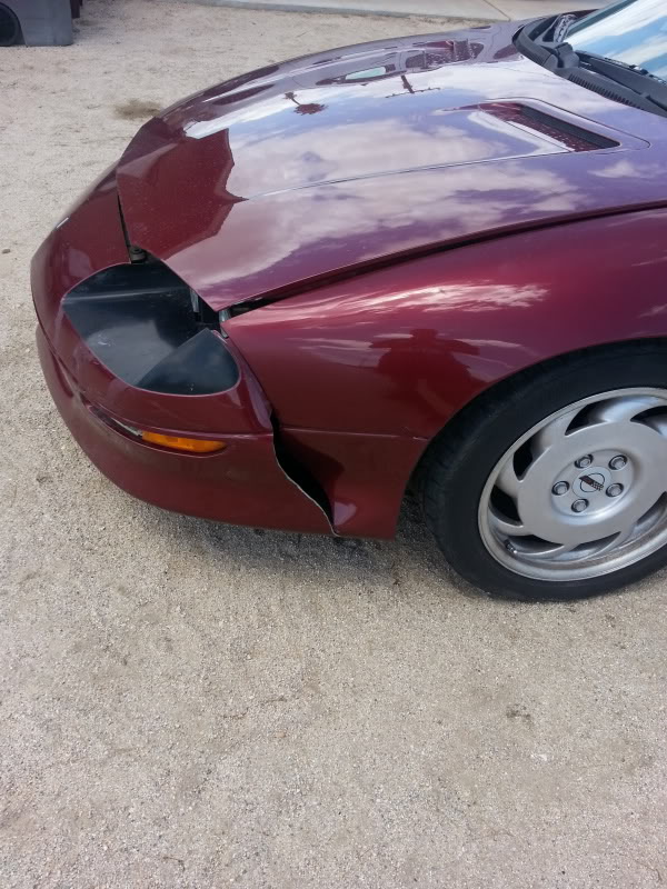

-Needs a new bumper and driver front fender...considering a LS front end/headlight swap
-Weak key fob response
-Needs exhaust
-A/C is charged and blows cold but only when the AC compressor relay is pulled and you jump the terminals; but blows strong and cold when that's done; haven't checked the in car fuses yet just the fuse block at the motor
-ABS INOP light on; but brakes work fine and have a 3rd brake light
-Passenger window trim on the outside pops out
-Little interior parts: Blown speakers, center console needs pin for hinge, glovebox doesn't always latch
-Slow power windows
All the issues listed above taken into consideration I'm happy with the car. It drives fine and doesn't seem to have any issues. I have taken it on some trips and it did just fine and still wasn't too much of a gas hog.
Being stationed in 29 Palms, CA and recently having a baby my first priority is AC followed by exhaust and SES light. This isn't my DD, more of a weekend car, but I would like to be able to drive it comfortably when I need/want to. I will add more as it comes to me....Pictures attached.
