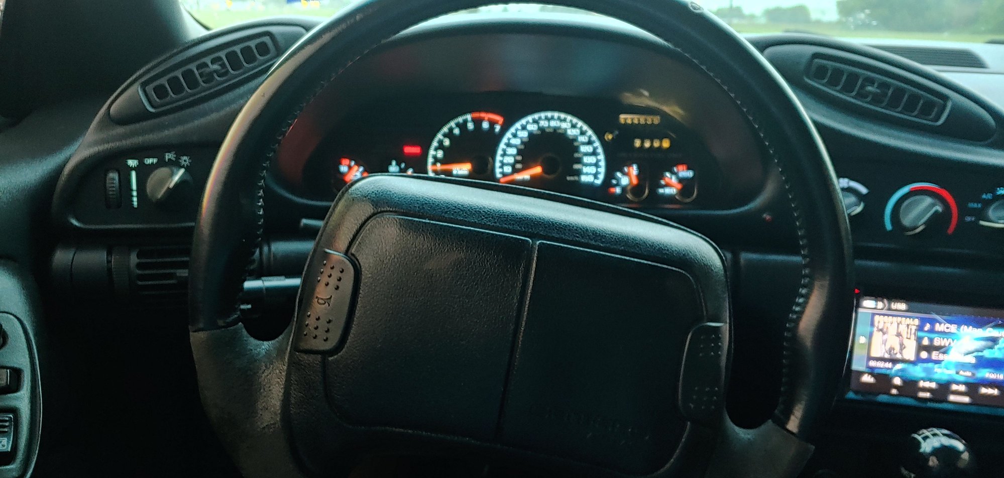

All the plugs look black like soot not oil. The Firecore wires are on correct and they are numbered. I am using twice as much gas as I normally do only driving like 80 miles a day 4 days a week mostly highway. when its running good in the morning it gets better gas mileage. It runs worse at tempertures in high 80s and 90s. My scanner shows all the cells and BLMs and most other stuff but it wont create a file or log anything. Maybe I can get someone to ride along and write stuff down. Two weeks ago I put a new MSD cap and rotor on the opti but the other cap looks pretty good. The bearings had a little play in them so I had a cheap new opti with good bearing that I used but I put the mitsubishi sensor in the cheap opti base. Still it ran the same as the other opti with the play in the bearings. Maybe the sensor is the problem... Also put a new opti harness on it two weeks ago. Coil wire looks good. I checked it out 2 days ago. Don't know if this matters but although my car is a 1995 . About 7 or 8 years ago I had a guy put another engine in it. He said it was the same year engine. A Few years later I had opti problems and come to find out it had the opti with the splines on it but I never knew the difference cause all of my 1995 stuff was on it and the same computer and it ran very well. I did notice the pcv hose was different. It looked like a horse shoe shape. In 2018 I bought an opti from Brad, the Ebay guy that use to rebuild them. Come to find out I a wiring issue on my icm wiring and that was the real problem. So I still have that old Mitsubishi sensor was a working sensor and I might try swapping that sensor with the Mitsubishi sensor from Brads opti. The ebay guy. Also the problems started before I used the cheap opti base. and the rotor was clocked in the right position.
Attached Thumbnails 5 sets plug wires all flickering in the dark. 1995 z28 m6-20230616_175234.jpg
