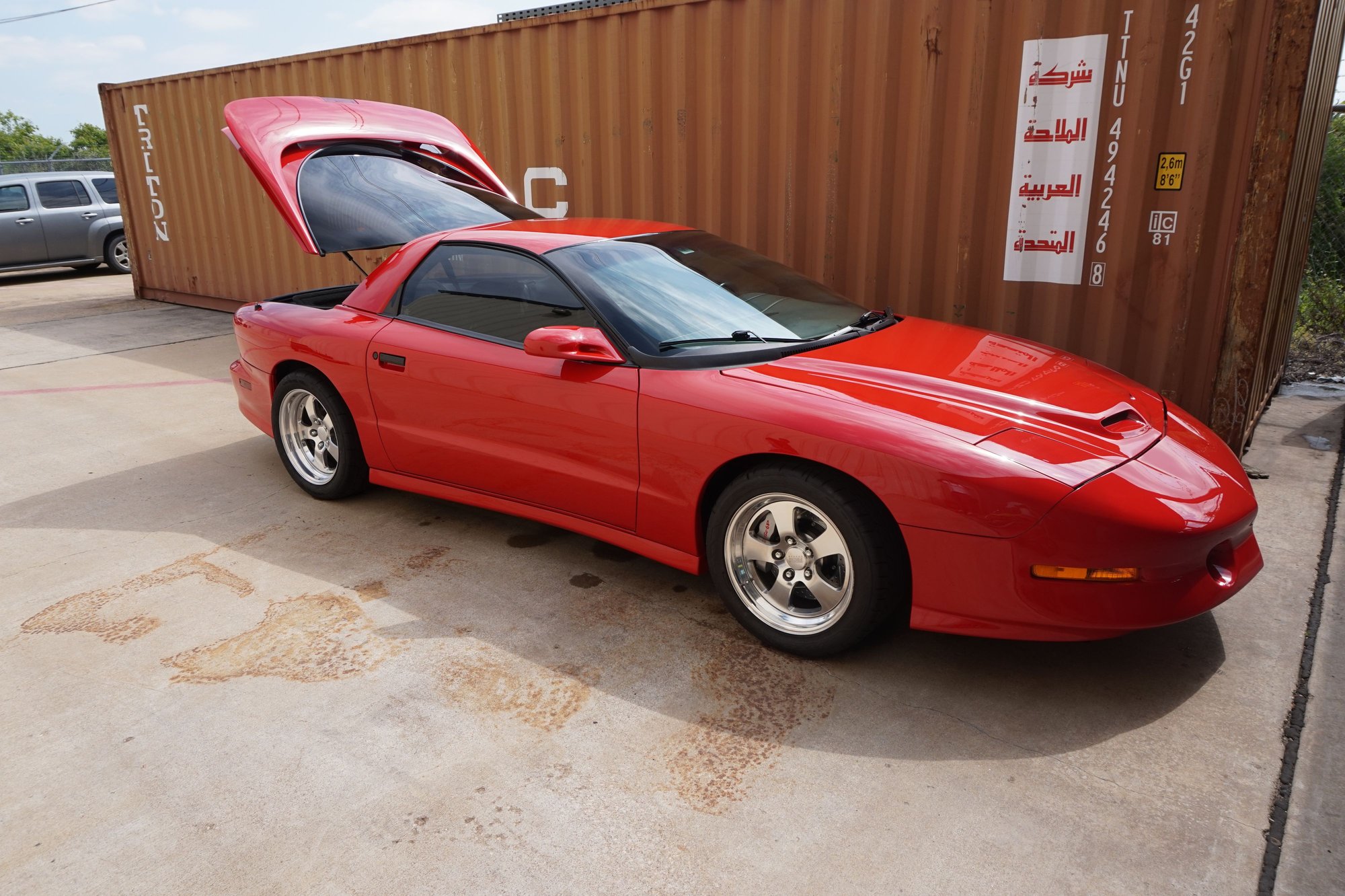

Borla closed 468 RWHP / 421 RWTQ / Borla open 489 RWHP / 439 RWTQ
That's corrected, no tricks, we didn't take the belt off or pull the filter, left the 17X11s on it. Car has a Strange 12 Bolt with a Spohn steel drive shaft. I remember there was a dyno at an import shop, that we used to use, and this car would make 20 rwhp more on that dyno then on this one, kinda funny looking back.

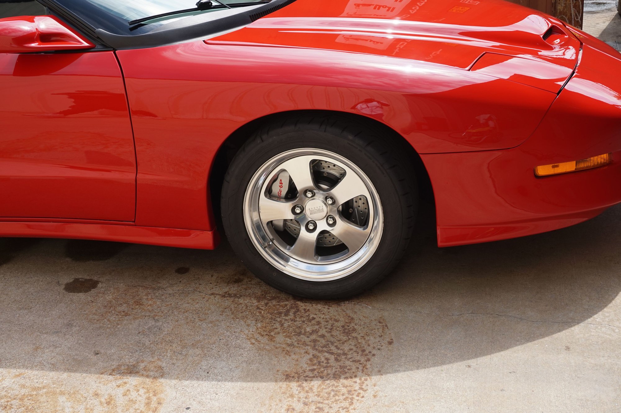

The car got a set of Baer Brakes, that's more of a childhood dream than anything. But I took it back to the body shop that painted in 2015, they're currently fixing the rear quarter panels on it.

Dyno: First pull was 511 rwhp up from 488 rwhp, second was 518 rwhp and the third was 525 rwhp / 467 rwtq. I think a lot of the gain was the plugs getting cleaning off with some wide open throttle therapy and naturally everything getting warmed up far as oil, etc. IAT were 98*F on each pull. Again, no tricks, belt was on, filter was in it, save 12 Bolt, 17X11s and steel drive shaft. Just as it is on the street. Other changes were a Motion 92 mm throttle body and new cable, same Wilson 90 elbow.
