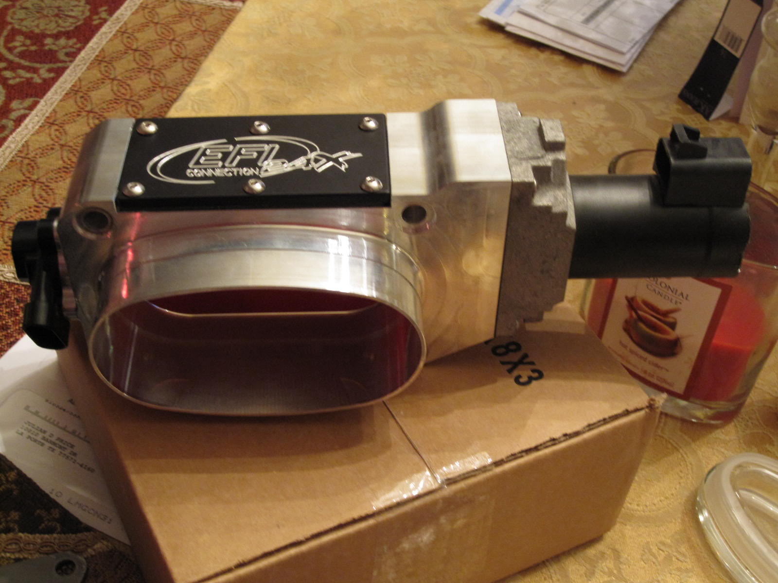

I wound up going with the EFI connection 24x conversion with drive by wire throttle body. I had a custom harness made by EFI connection that will be going on soon. (just got it about 2 weeks ago)
Just got a base tune back on my LS1 PCM for this car and had to run a 2002 corvette tune to help control the throttlbody. (since it is drive by wire at this point) From what I understand it is one of a kind right now, as nobody else has gone the drive by wire route with LT1 F body yet. Benefits of running this system will be much improved idle with bigger cams, and computer is supposed to make more power over stock setup. Overall this is a much better setup than what I was going with originally.

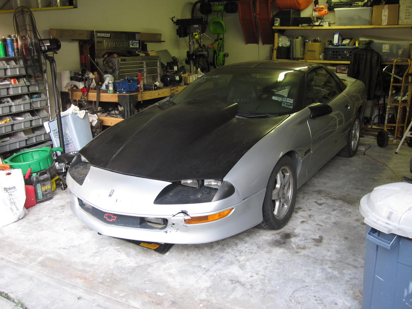

Here are a few pics . Car also got a new hood.

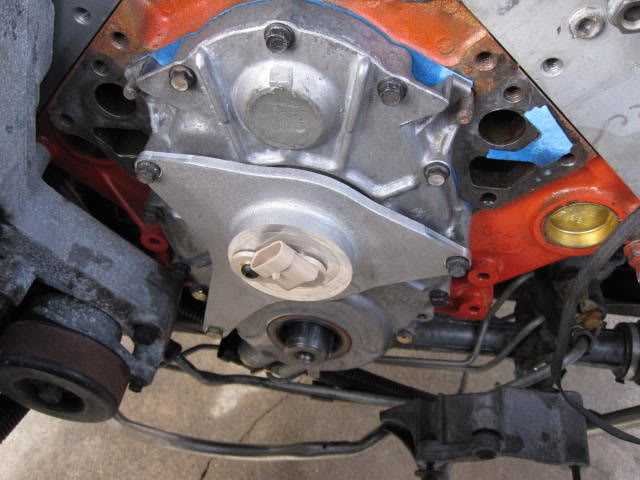

That is the mechanical end of the 24x conversion. It replaces the stock reluctor wheel on crank(96 and 97 had a reluctor for misfire) with a 24 position reluctor. This helps ls1 PCM keep tabs on crank position.
The upper reluctor wheel on cam end creates a way for the plate mounted sensor to give cam position to PCM.
The PCM uses both of these sensors to make calculations for when to fire the coil packs. (I have mounted ls2 coil packs)
Basically you get rid of your front mounted optispark, and gain tuning flexability, while making more overall power. All of this needs a different harness or one that's been modified.

Hood is sunoco wide.
