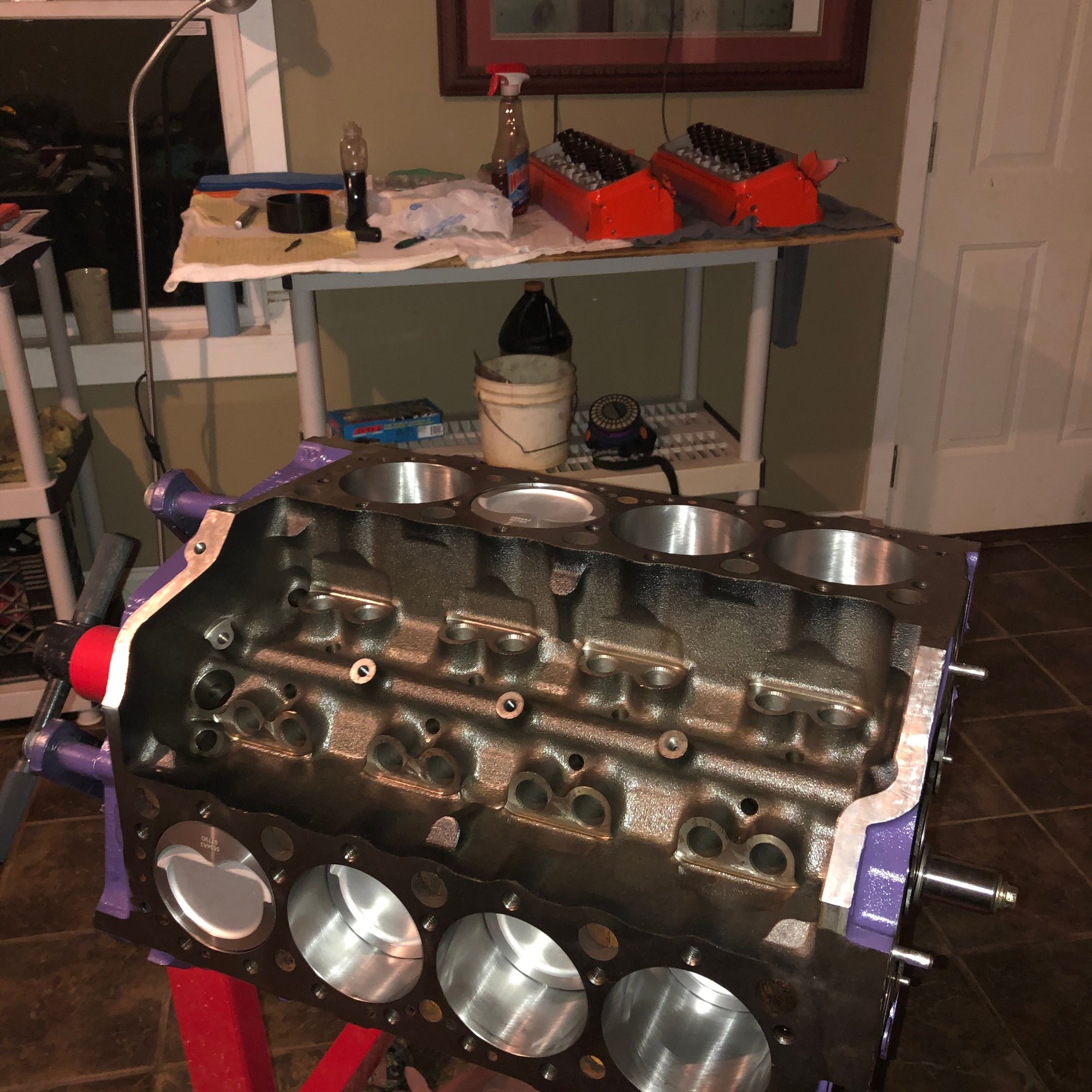

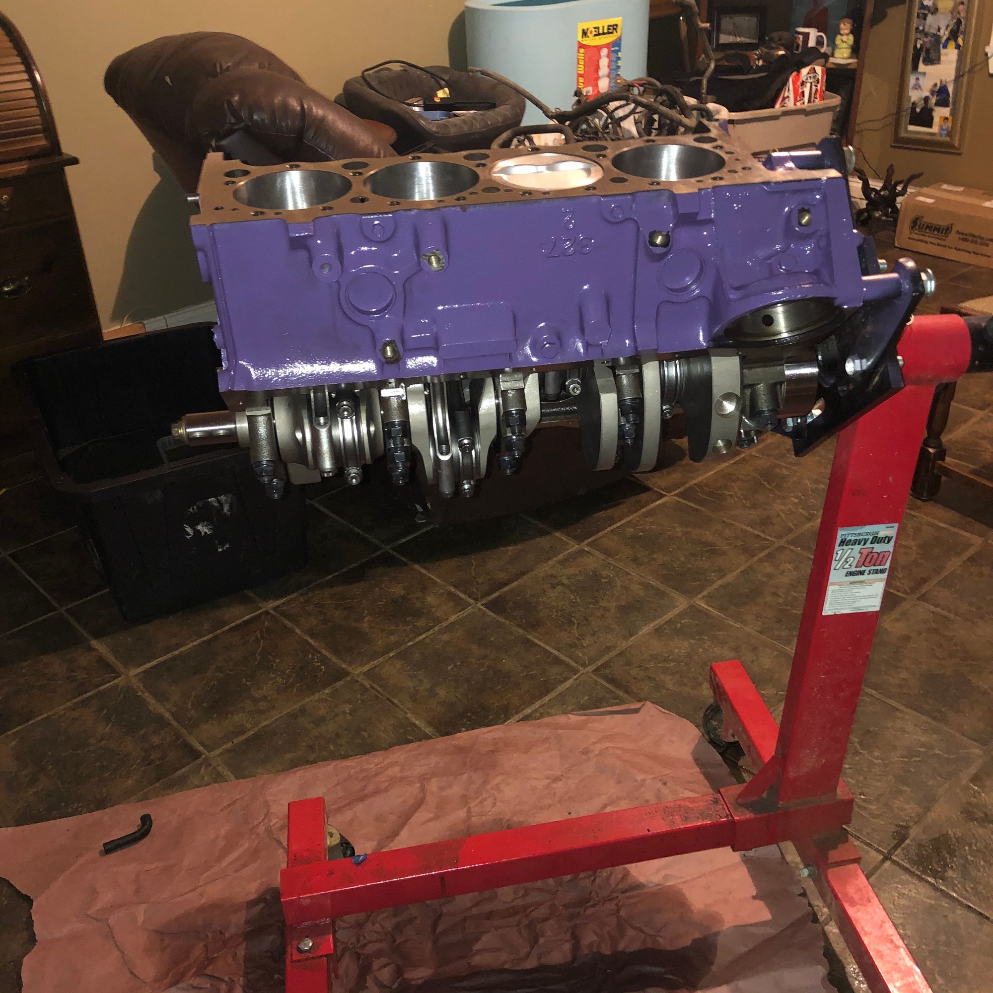

here is the build
LPC forged balanced rotating 383
wiseco flat top forged
arp hardware
rather than chase more numbers I’m using lt1 heads 3 way valve job bowl blended
llunati recommendation is 228/234. 478/480 112 for type of driving most likely I’ll keep factory 3:43 gears.
considering hedman long tube headers
I’ll do a can tune. Looking like 30Lb injectors.
ive
I’ll eventually have some numbers one day for all those eager to see. It’s been fun learning should be ready to go by October.

Old Aug 24, 2020 | 10:16 PM
  #27
Posts: 71,112
Re: 383 build
“Flat top” pistons? They looked dished? Or is it just the photo?
Old Aug 25, 2020 | 05:23 AM
  #28
Jwdw1978's Avatar
Joined: Oct 2019
Posts: 47
Re: 383 build
you are correct. Appreciate you pointing that out.
Old Aug 25, 2020 | 05:31 AM
  #29
Jwdw1978's Avatar
Joined: Oct 2019
Posts: 47
Re: 383 build
what do you think of the cam specs? I know the top end will be weak compared to the bottom but part of the idea is to give me a solid build that I can rev on safely when I’m out on track or street.
i
when I do buy heads for the engine later I’ll get the top end that we all know will make serious power.
Ill be glad to get this car back together. It’s been apart almost a year now.
Old Aug 25, 2020 | 11:36 AM
  #30
Posts: 71,112
Re: 383 build
How does that piston dish affect your static compression ratio calculations? Wiseco also adds compression height to some of their pistons to reduce effective deck height.
Is the gross lift on the cam w/ 1.5X or 1.6X rockers? And the heads are stock, except for a "valve job"?
And just to help you make your posts accurate.... the stock gears with the T56 are 3.42:1, not 3:43.
