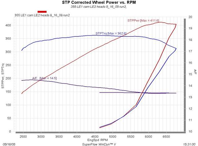

From: Kantuckee Yo'
Originally Posted by OPies57
ive heard some issues with the 6.0 inche rods like they drink oil and make the motor not as driveable that true?
Bunk. My 355 has 6" Scat forged rods and drivability is outstanding and power is awesome.
